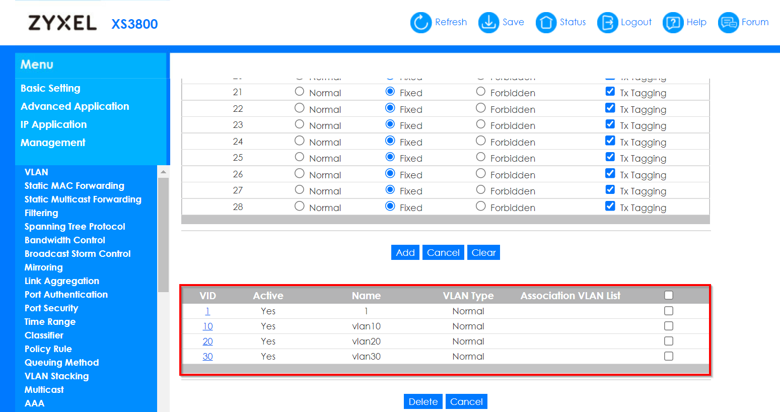

Now we add the same  VLANs on the Switch.
Advanced Application > VLAN > VLAN Configuration > Static VLAN Setup

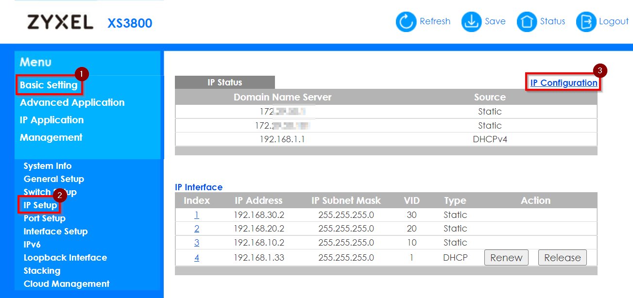

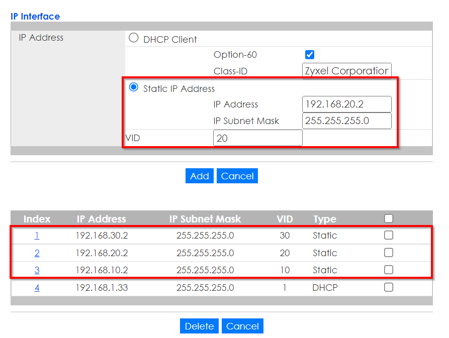

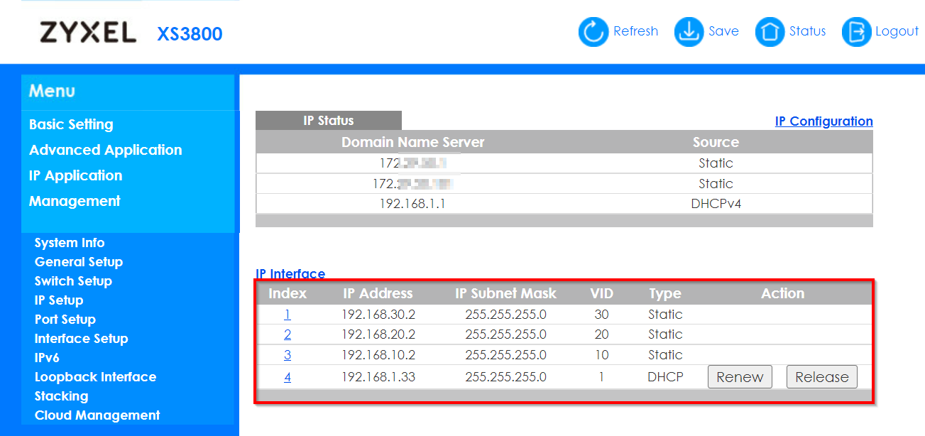

Then we need to give the Switch an IP in each of those VLANs
Basic Setting > IP Setup > IP Configuration
