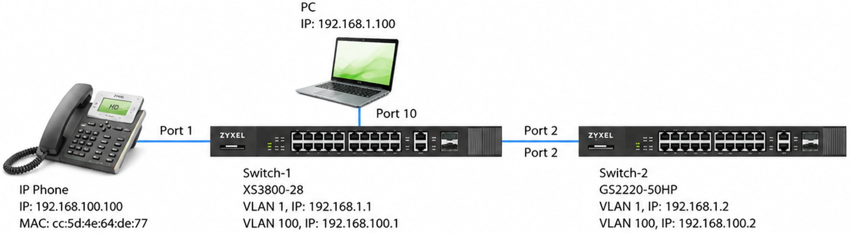

Network Topology
Network Topology
The example topology consists of:
  • An IP Phone connected to Switch-1 (XS3800-28).
  • A PC connected to Switch-1.
  • Switch-1 connected to Switch-2 (GS2220-50HP).
  • Voice traffic is carried through VLAN 100, while management remains on VLAN 1.

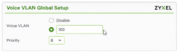

Step 2 – Configure Voice VLAN
Navigate to:
Menu → Switching → VLAN → Voice VLAN Setup → Voice VLAN Global Setup
Configure:
  • Voice VLAN: 100
  • Priority: 6
Click Add.
Configure Voice VLAN: 100  Priority: 6
The configured priority (802.1p CoS) marks voice packets so that switches can prioritize them over normal data traffic.

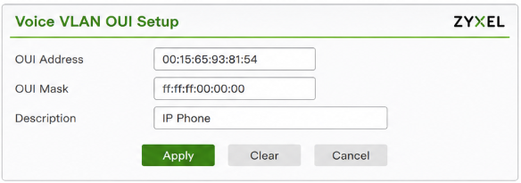

Configure the Voice VLAN OUI
Next, configure the OUI (Organizationally Unique Identifier) used to recognize supported IP phones.
Navigate to:
Menu → Switching → VLAN → Voice VLAN Setup → Voice VLAN OUI Setup
Configure:
  • OUI Address: 00:15:65:93:81:54
  • OUI Mask: ff:ff:ff:00:00:00
  • Description: IP Phone
Click Add (or Apply, depending on the firmware version).
Configure:  OUI Address: 00:15:65:93:81:54  OUI Mask: ff:ff:ff:00:00:00  Description: IP Phone
Note: With this configuration, the switch automatically recognizes devices whose MAC addresses match the specified OUI and assigns their traffic to the configured Voice VLAN.

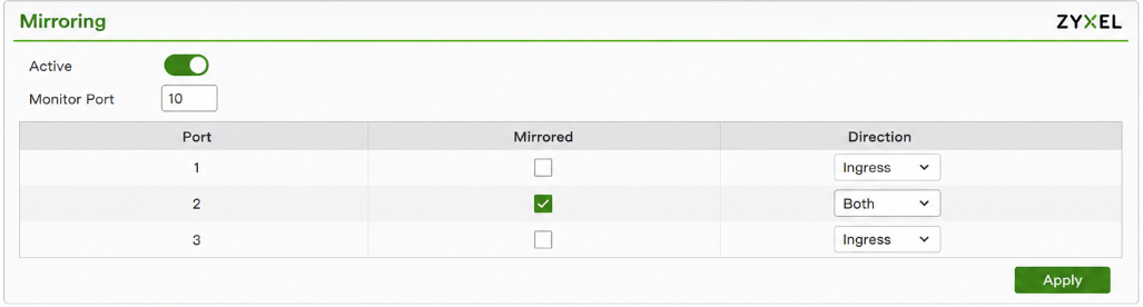

Step 3 – Configure Port Mirroring (Verification)
To verify that Voice VLAN is working correctly, configure port mirroring.
Navigate to:
Menu → Switching → Mirroring → Mirroring
Configure the following:
  • Active: Enabled
  • Monitor Port: Port connected to the monitoring PC
  • Mirrored Port: Port connected to the IP Phone (Port 2 in this example)
  • Direction: Both
Click Apply.
Port mirroring allows Wireshark to capture all traffic passing through the selected switch port for verification.

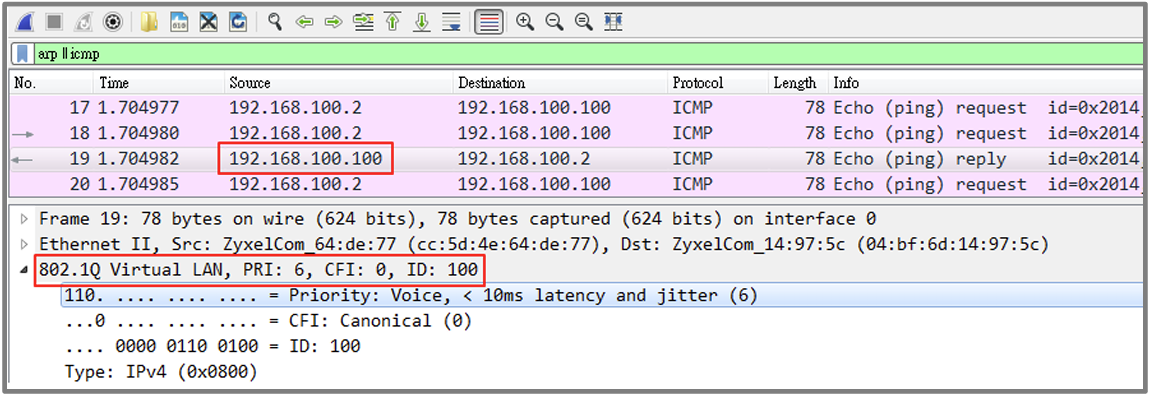

Step 4 – Verify the Configuration
Connect the monitoring PC to the configured monitor port.
Open Wireshark and apply the following display filter:
arp || igmp
Next:
  1. Log in to Switch-2.
  2. Navigate to:
    Menu → Management → Diagnostic → Ping Test
  3. Ping the IP Phone.
The ping should complete successfully.
(Insert improved Wireshark screenshot here.)
Inspect the captured packets in Wireshark.
The Ethernet frame should show:
  • 802.1Q VLAN ID: 100
  • 802.1p Priority: 6
This confirms that the switch has correctly identified the IP phone, assigned it to the configured Voice VLAN, and applied the configured QoS priority.
