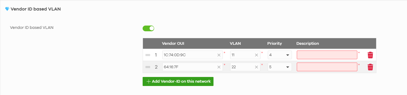

Configure Vendor ID-based VLAN in Nebula
OUI format explanation
OUI is the first part of a MAC address that identifies the device vendor.
For example: 64:16:7F
matches devices in the MAC address range: 64:16:7F:00:00:00 to 64:16:7F:FF:FF:FF
Another example: 1C:74:0D:9C
matches: 1C:74:0D:9C:00:00 to 1C:74:0D:9C:FF:FF
Site-wide > Configure > Switches > Switches settings > Vendor ID based VLAN

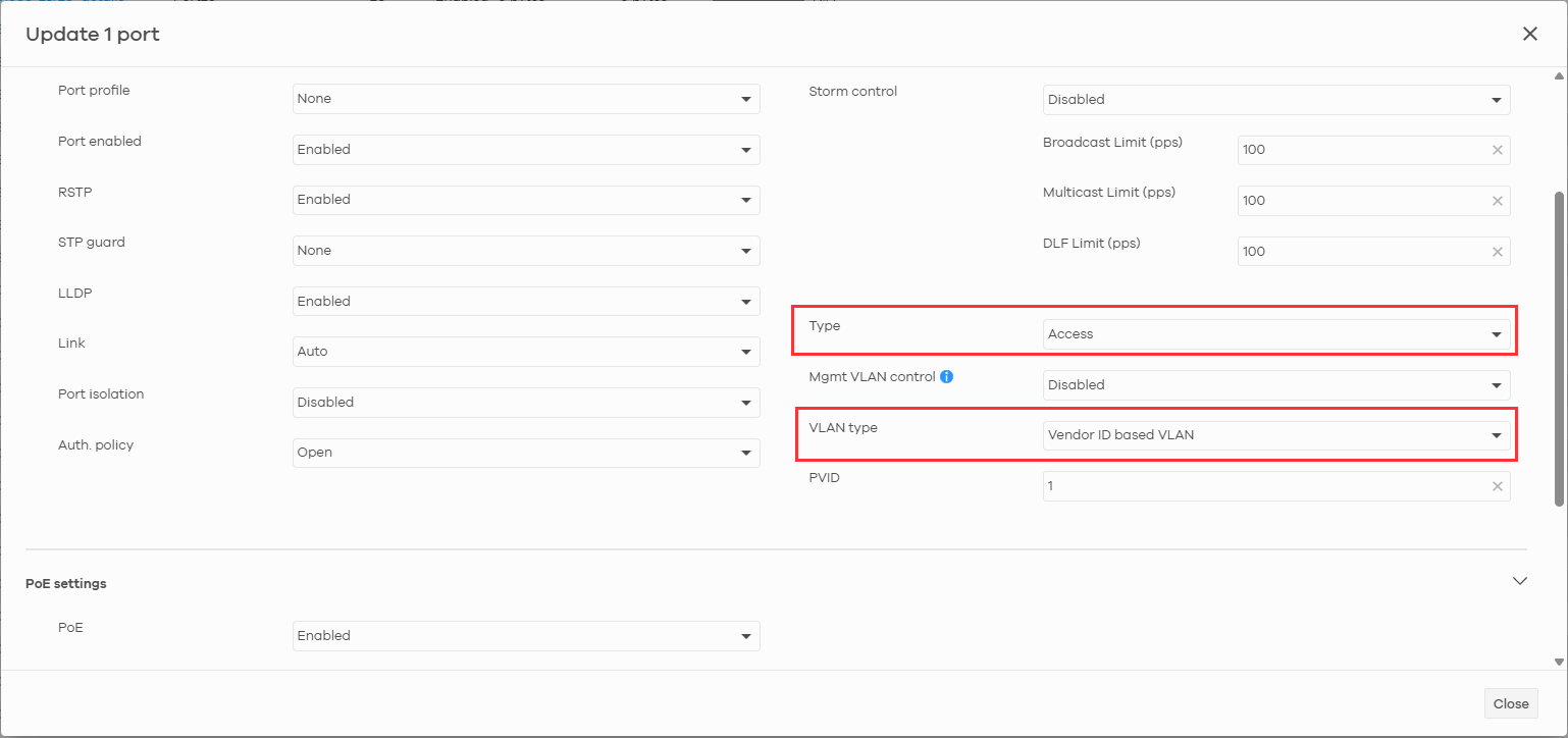

Site-wide > Configure > Switches > Switch ports
The port type needs to be changed to access port; otherwise, the VLAN type is hidden.
PVID is used as the default VLAN for untagged traffic that does not match any Vendor ID based VLAN rule. When using a Vendor ID based VLAN, you usually do not need to change the port PVID to the Vendor VLAN ID. Keep the PVID as the fallback/default VLAN, for example VLAN 1, unless you specifically want all non-matching devices on this port to be placed into another VLAN.

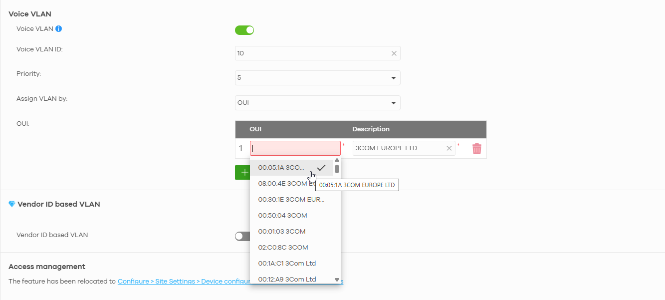

Configure Voice VLAN in Nebula
Voice VLAN is used to separate voice traffic from regular data traffic in a network where an IP phone and a PC may be connected through the same switch port. This helps ensure that voice packets from the IP phone are identified, placed into the correct VLAN, and given higher priority, while normal data traffic from the PC remains in the data VLAN.
In Nebula, the configuration is simplified: the switch port is configured as an Access port with a PVID for data traffic, while the Voice VLAN feature identifies IP phones by their OUI/MAC vendor information and applies the configured Voice VLAN automatically. This allows voice and data traffic to be separated without manually configuring VLAN tags on each IP phone.
Site-wide > Configure > Switches > Switch Settings
Then configure Voice VLAN settings. Specify the VLAN ID and OUI addresses of the IP phones. OUI are the first 3 bytes (first six digits) of a MAC address that represents the vendor. By specifying the IP phone MAC address, the switch can identify voice traffic accordingly. Nebula cloud switch supports up to 6 vendor OUIs.

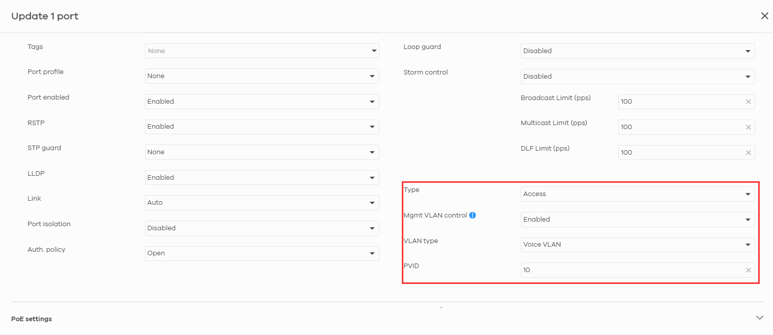

Site-wide > Configure > Switches > Switch Port
Select and edit the port(s) which are connected to the IP phones, and set the port type as “access”. Assign a PVID for the ports. PVID is used to tag the data packets with the VLAN ID. Next, we’ll use the “Voice VLAN” feature to identify the voice packets for the switch.
