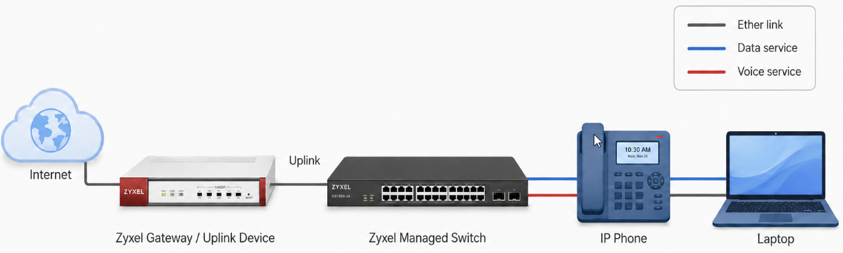

In a common setup, an IP phone is connected directly to the switch, while a PC or laptop is connected behind the phone. In this scenario, Voice VLAN helps separate voice traffic from regular data traffic and allows the switch to prioritize voice packets from the IP phone.
Scenario and Topology
The goal of this configuration is to separate traffic between the IP phone and the PC without manually configuring individual VLAN tags on each device. The switch will handle voice and data traffic separately and forward it to the uplink with the required VLAN settings.

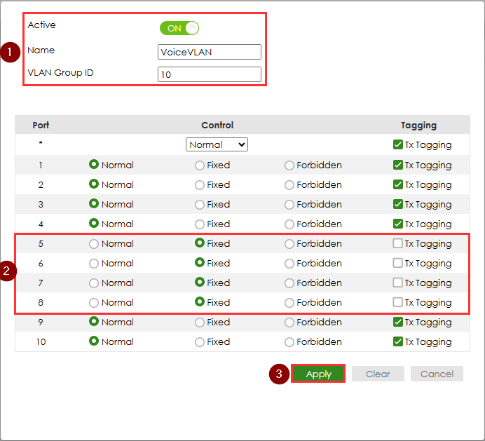

Create a VLAN for voice packet transmission, select ports that are connected to IP phone, and unselect Tx tagging as to save the effort of configuring VLAN on each phone.
SWITCHING > VLAN > VLAN Setup > Static VLAN > Add/Edit
Create a VLAN for voice packets transmission, select ports which are connected to IP phone, unselect Tx tagging as to save efforts of configuring VLAN on each phone.

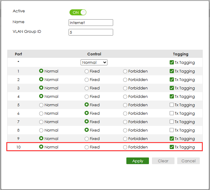

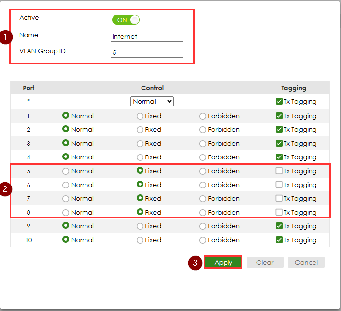

Create another VLAN for data packets, select member ports, and unselect Tx tagging. Port 10, the uplink port, and Tx tagging should be enabled to transmit packets with VLAN tags

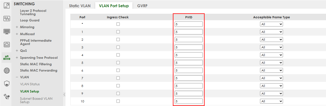

Configure PVID to separate data packets from voice packets. PVID number should be the same as the VLAN number created for data packets.
Note! You can write PVID 5 on * which will make all ports the same PVID:

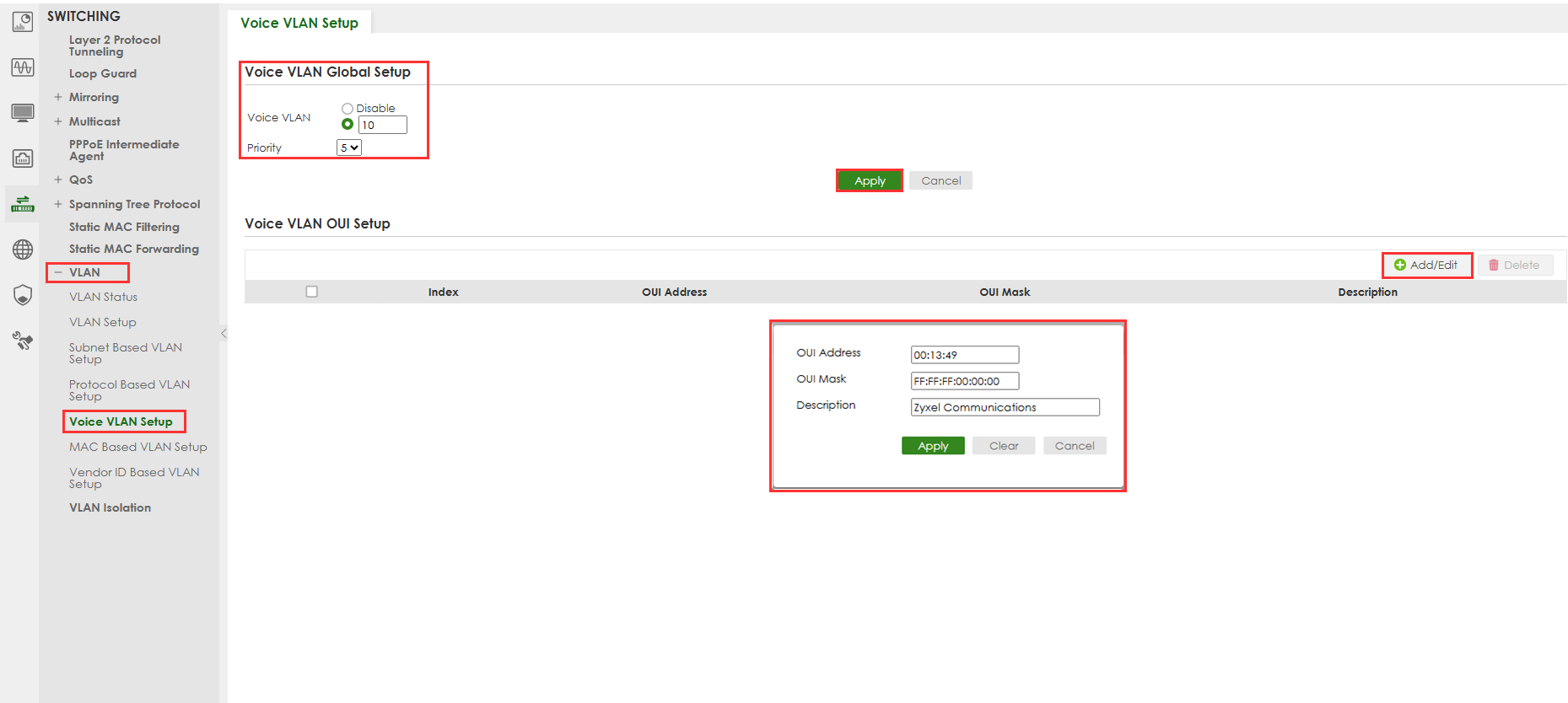

After setting PVID for data packets, the next step is to configure the “Voice VLAN” feature for the switch to identify the voice packets.
Configure Voice VLAN
Configure Voice VLAN number and priority to prioritize the voice packets. The Voice VLAN number should be the same as the VLAN number created earlier for voice service packets.
Specify the OUI addresses. OUI are the first 3 bytes of a MAC address that represent the vendor. By specifying the IP phone MAC address, the switch can identify voice traffic accordingly. Zyxel switch supports up to 6 vendor OUIs.
