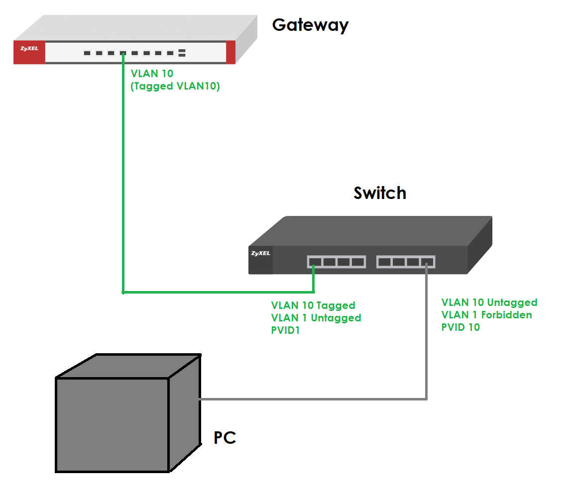

The uplink port to our router is VLAN-capable, while the PC Edge-Port is VLAN-incapable. The tutorial below on this example shows you how to set up switch-ports for both tagged and untagged VLANs.

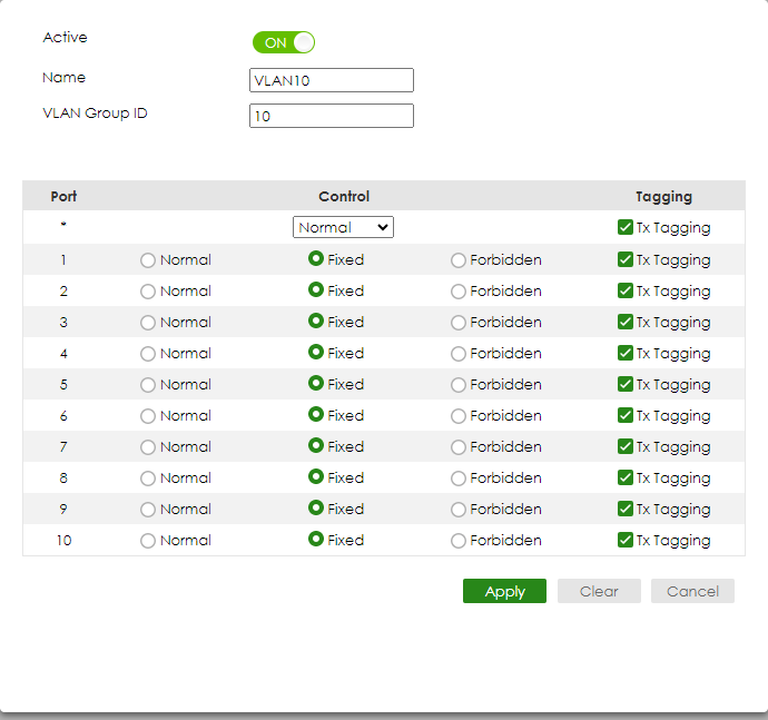

VLAN10
In this menu, create a VLAN by activating the VLAN, giving it a Name (we went here for "VLAN10" and assigned the VLAN-ID - in our example 10. Afterwards, set the membership of the ports you want to set to "Fixed", set up tagging (since we want these ports tagged) and then press "Add" to apply the setting and create the VLAN.

Sometimes, the end device in question is not VLAN-capable but still shall join a VLAN (like most PCs do not have VLAN settings within their network interface cards). In our example, a PC connected to Port 10 of our GS2200 switch is supposed to become a member of VLAN10 without actually having VLAN established on its network interface card. For this, navigate again to

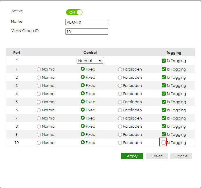

SWITCHING > VLAN > VLAN Setup > Static VLAN
This time, we will choose the Port our PC is connected to to be an untagged member in VLAN 10. For this, we set membership status to "Fixed" while unchecking the "Tagged"- Checkbox.
After that, we press again "Apply" to apply our settings.

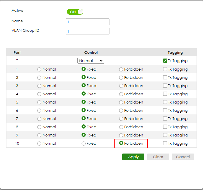

Please note that only one untagged membership per Port is allowed! This automatically means that we have to take away the default untagged membership in VLAN1. Mark the VID1 and click "Add/edit" to edit the VLAN1:
VLAN1
Here, ensure that you have VLAN1 set for the VLAN10-untagged Port to "Forbidden", or tag it via Tx-Tagging-Checkbox. Afterwards, save temporarily via the "Apply" button.

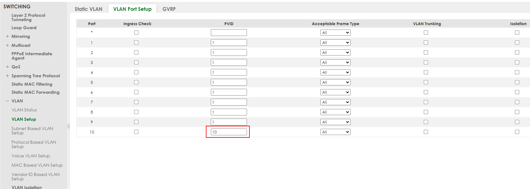

As a next step, it is important to know that the PVID of a port must always match its untagged membership - so we still have to set up the PVID of Port10 of the switch to being 10. This can be done via:
SWITCHING > VLAN > VLAN Setup > VLAN Port Setup
Here, you can set the PVID according to our needs:
PVID

The most important learning out of this generic setup example are:
  • Tagged and untagged VLANs are set up differently (Tagged Membership vs. Untagged Membership+PVID)
  • Only one untagged membership per Port allowed
  • PVID has to match the untagged membership
