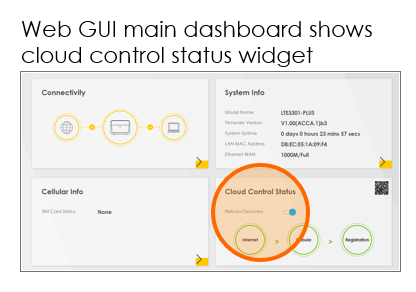

Nebula Software Variant – supports NCC discovery.
How to recognize software variants of the mobile Router?​
