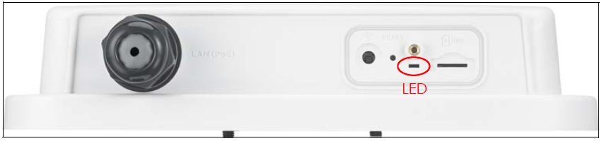

LED Lights
Where can you find LED lights, and what do they mean?
COLOR STATUS DESCRIPTION
Red On The device is not connected to internet
Red Blinking The device is booting or self-testing
Red Off There is a system failure
Green On The device is connected to internet
Green Blinking The device is trying to connect to internet
Amber On The device is connected to internet and the wireless network is activated
Amber Blinking The device is not connected to internet but the wireless network is activated
Red/Green/ Amber Scrolling The device's firmware upgrade is in progress

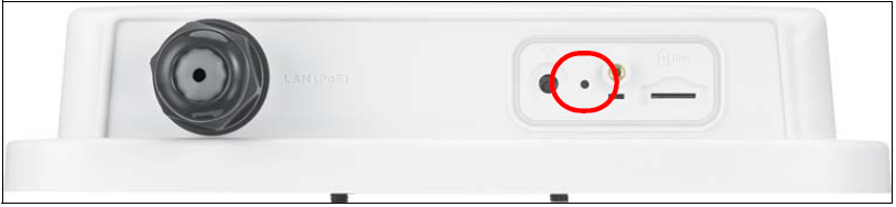

Reset the device
If you have recurring problems with the device, you can use the reset button to reset it back to factory defaults, which is a great way to solve most recurring problems.
  • Make sure the device is connected to power and the power LED is on
  • Press and hold the Reset button for 15 seconds
  • Wait until the device reboots and you can reach the device again

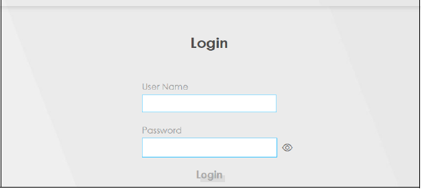

Login to the device
To reach the device's web interface (where you can configure the device), you need to first login to the WiFi of the device, go into your web browser and type http://192.168.1.1 - you will then get to this page:

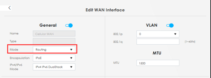

Bridge mode (IP Passthrough mode)
If you want to set the LTE7490 to bridge mode (which means that all the traffic will be automatically forwarded to the router you have behind the LTE7490).
  • Go to network setting -> Broadband -> Add/Edit New WAN interface
  • Change the Mode from Routing to Bridge
  • Click Apply

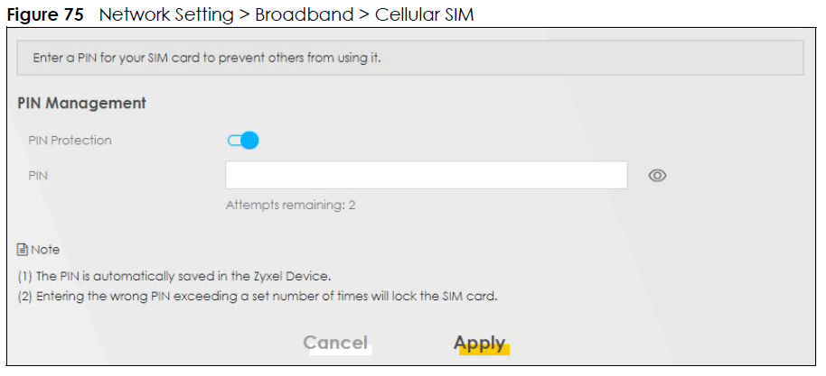

Asking for PIN every reboot
If you are experiencing that you have to insert your PIN code to the SIM-card every time you login, you can disable PIN protection under
Network Setting -> Broadband -> Cellular SIM

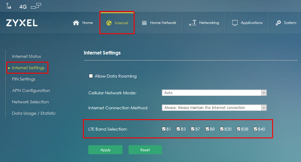

The device connects to the same band with a poor signal
  • If the LTE7460 always connects to the same band with poor signal, please check the "LTE Band Selection" on Internet > Internet Settings > LTE Band Selection and see whether some of the LTE bands are disabled on the web interface.
  • Most service providers have their network coverage map on the Internet, some of them or the radio communication government body even show the coverage in each LTE bands. You may confirm to the band coverage of your location by the map. It is notable that the coverage is not constant but changing. If your location is at the periphery of the coverage, the signal may need improvement, and you may expect intermittent services at some points.
  • The LTE7460's LTE antenna is directional; therefore, if the signal is always poor, you could also re-position the LTE7460 to get a better signal.
