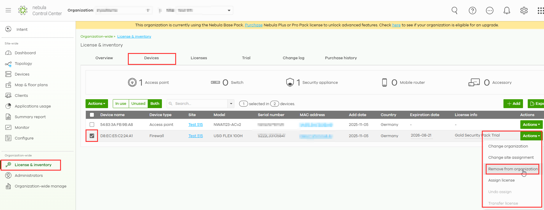

Remove the device from your organization
  • Log in to your Nebula account (https://nebula.zyxel.com).
  • Go to Organization > Configure > License & Inventory.
  • Locate the device in the list.

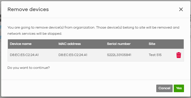

  • Click Remove from organization.
  • Confirm the removal. The device will be unlinked from the current organization.
  • Log in with the new account and register the device again via Nebula Control Center using the QR code sticker (How to register Firewall in Nebula via QR code ?).

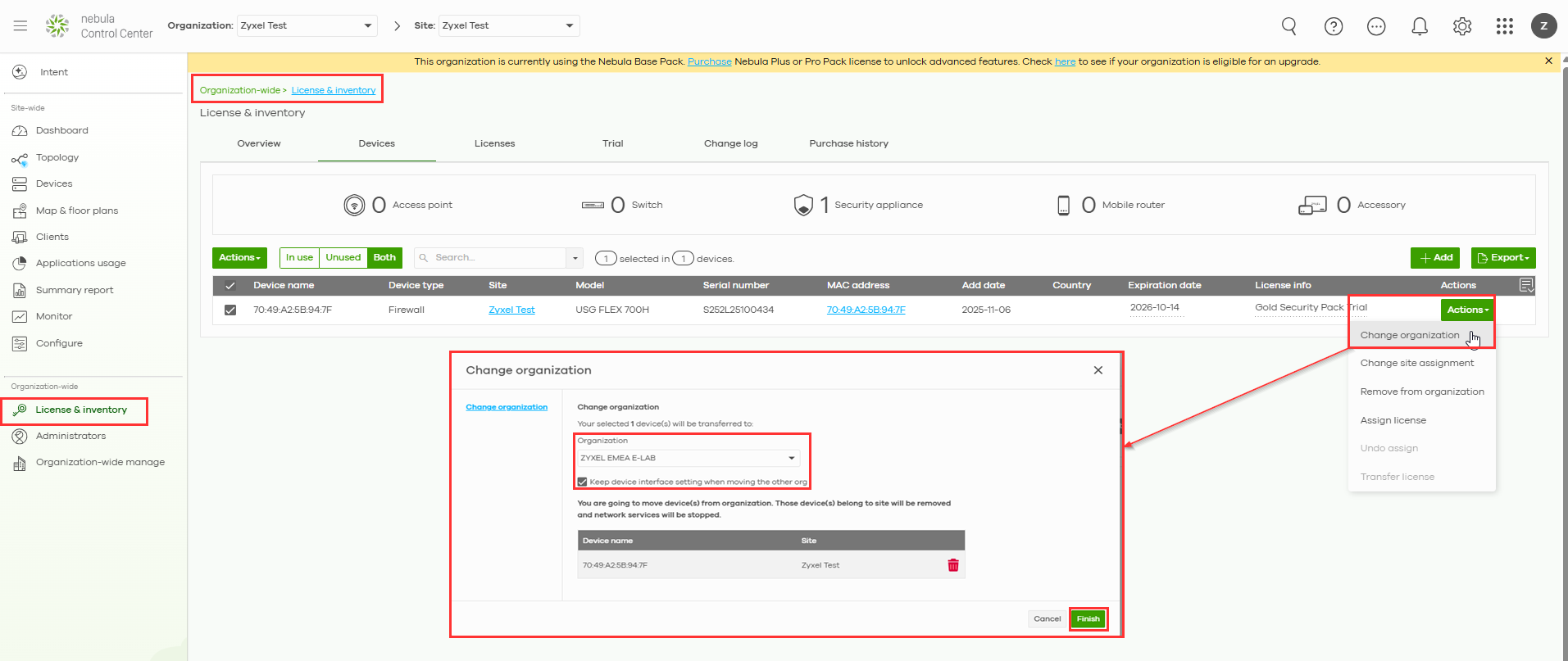

Transfer the device between two organizations or between two sites within the same organization
Notes:
  • The Change organization function is only available if you are the owner of both organizations, meaning both organizations must be registered under the same account.
  • The Change site assignment function works only within the same organization and allows you to move a device between sites inside that organization.
  1. Log in to Nebula Control Center.
  2. Navigate to Organization > Configure > License & Inventory.
  3. Find the device and select Change Site Assignment.
  4. Choose the target site/organization and confirm.
