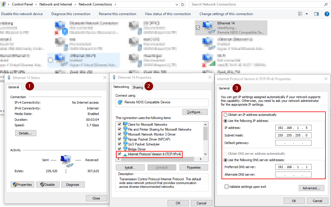

  • IP Address Configuration: Ensure that your computer's IP address is in the same subnet as the NR2301, ideally within the range of 192.168.1.2 to 192.168.1.254.

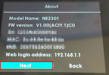

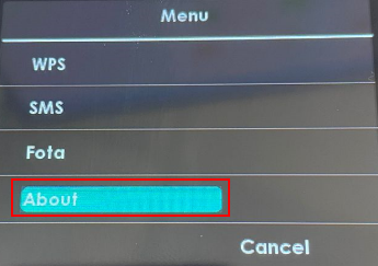

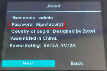

  • User name and password: User name: "admin" and password to access the web interface of NR2301 on the device itself, you can find on the LCD screen of the device select the item "Menu" then select the section "About" and press the button "Next", after performing these actions you will see the administrator password.
Note: If the administrator password was previously modified (this can be done via the Web GUI), you must use your custom password rather than the default password listed in the device menu. If the custom password is forgotten, the device can be reset to factory settings by pressing the "Reset" button.

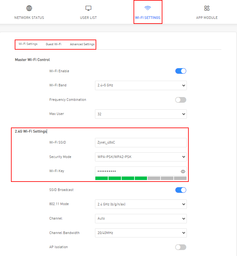

  • Navigate to "WIFI SETTINGS" on your device.
  • Modify essential settings like SSID Name, wireless password, and select the preferred security mode.
  • Additionally, you have the option to configure a separate guest WIFI network and establish an activity schedule for your SSIDs.
  • Note: Configuring a guest WIFI network adds an extra layer of security for your main network, and setting activity schedules can enhance energy efficiency and control network access.

  • The default username is “admin,” and the password can be found on the device menu screen. Go to “About” and select “Next.” Your password will appear on the screen, as in the example below.

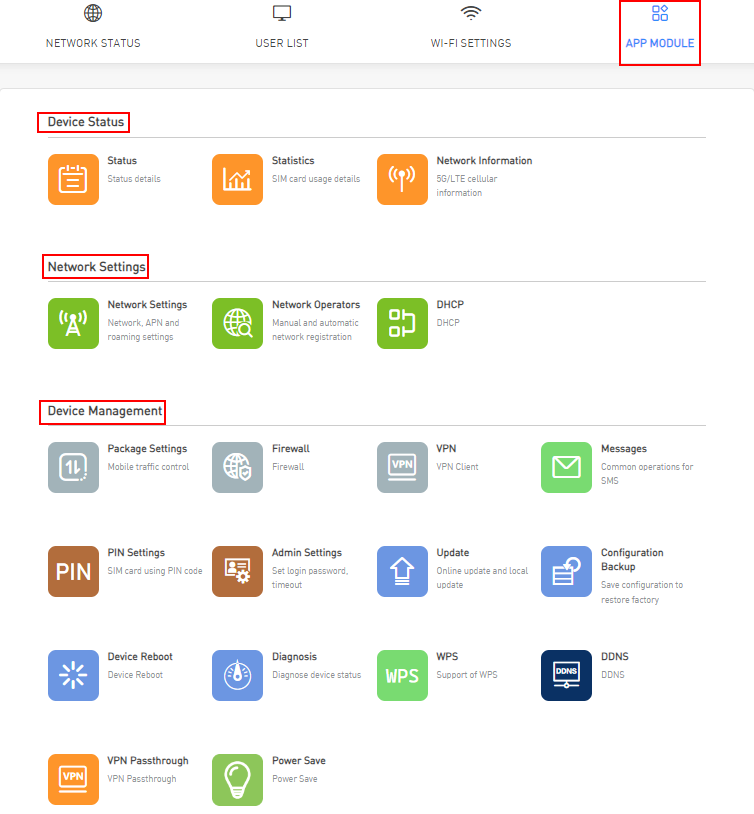

Advanced settings
In the "APP MODULE" section you will find a wider functionality of the device, which includes three sections:
  • Device Status
  • Network Settings
  • Device Management
