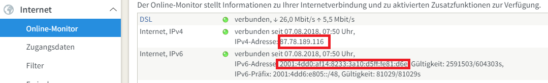

  • You must obtain an IPv4 address from your Internet service provider (ISP). This must not be behind double NAT.
    You can check it by checking your router's IP address provided by your ISP.
    IPv4 example: 85.241.35.14
    IPv6 example: 2001:4dd0:af14:8233:3a10:d5ff:fe81:d6e
    If the IPv4 address is in one of these three areas, it can be assumed that there is a double NAT:
    10.0.0.0 - 10.255.255.255
    172.16.0.0 - 172.31.255.255
    192.168.0.0 - 192.168.255.255
    These address ranges are private addresses. Please check which case applies to you.
    Please do not confuse these address ranges with the addresses you use internally.
    You can have your public IP determined by services offered on the Internet. If the IP determined by one of these services matches the IP provided by the ISP, you can assume that you have IPv4.
    (Example of public IPv4 and IPv6 addresses in AVM FritzBox)
