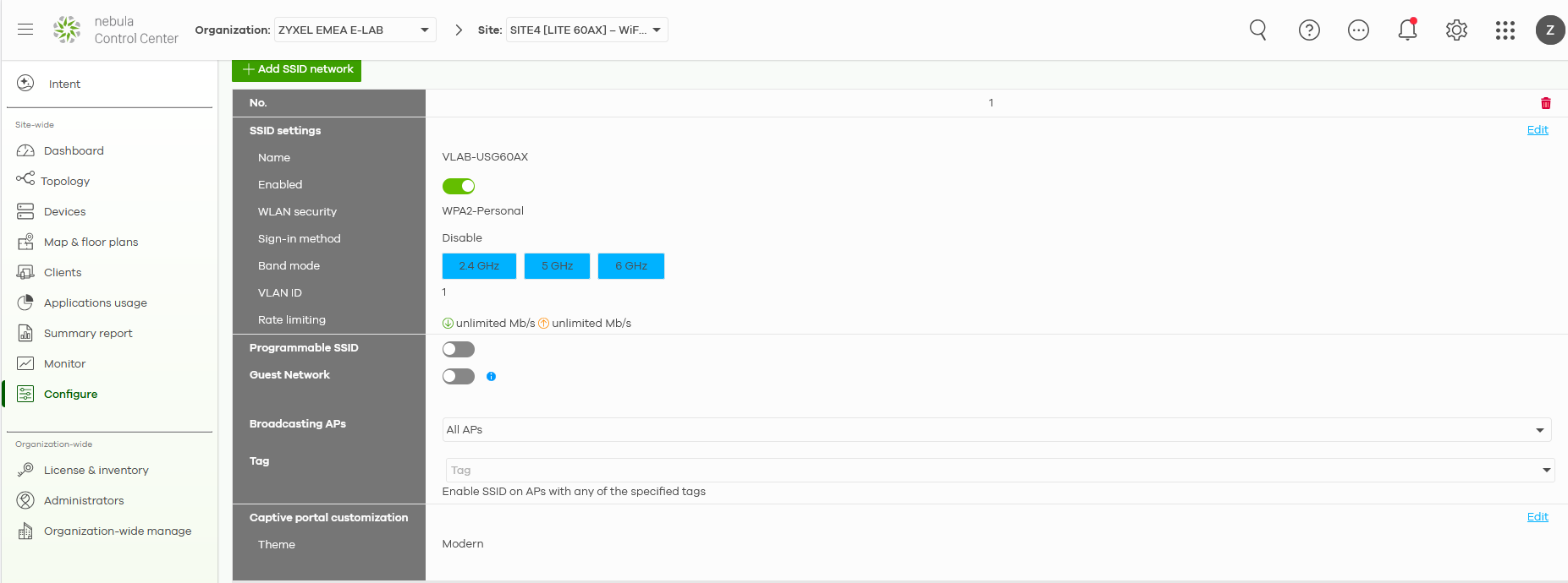

  • First, set up the SSID profiles according to your preferences using:
Site-wide > Configure > SSID Settings

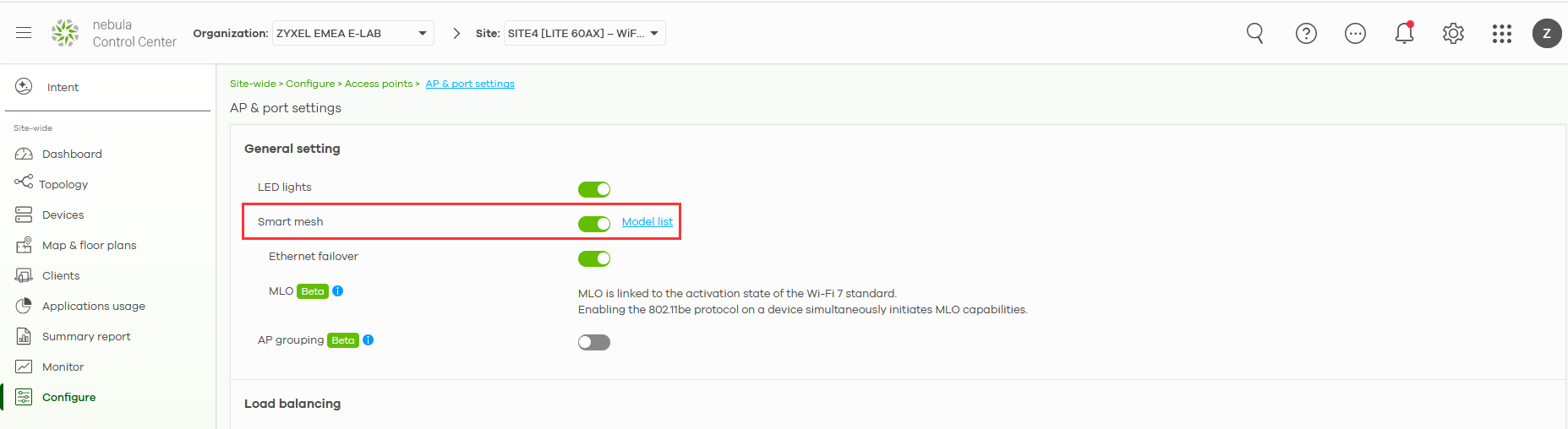

  • Then, make sure to turn on the “Smart Mesh” slider:
Site-wide > Configure > Access Point > AP & port settings
  • Then, make sure that Smart Mesh is enabled on every device.

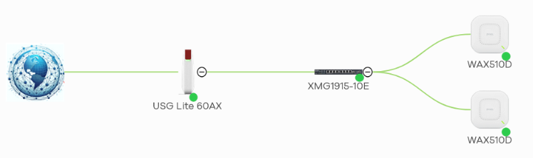

  • Make sure they both come online—this allows them to receive the configuration from Nebula.
Note: After making "any changes" to the settings, please wait approximately 7-10 minutes for the access point to receive the full configuration from the Nebula Control Centre (NCC).

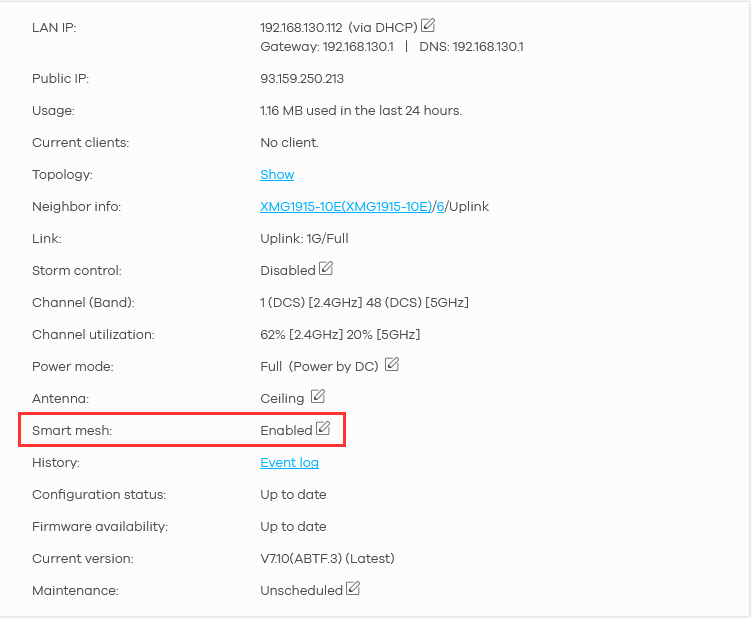

After enabling Smart Mesh and confirming that both APs are connected and online, disconnect the Repeater AP from power and network cables. Then move it to the desired location and connect it only to power.
Important: If the Repeater AP is placed too far from the Root AP, it may not be able to connect.
To avoid this, we recommend first placing the Repeater AP within visible range of the Root AP to confirm that it can establish a wireless link. Once the mesh connection is working, you can try moving it to your final location.
Wait for Mesh Link to Establish
The mesh connection will be created automatically.
Please wait up to 15 minutes for the Repeater AP to come back online through the mesh link.

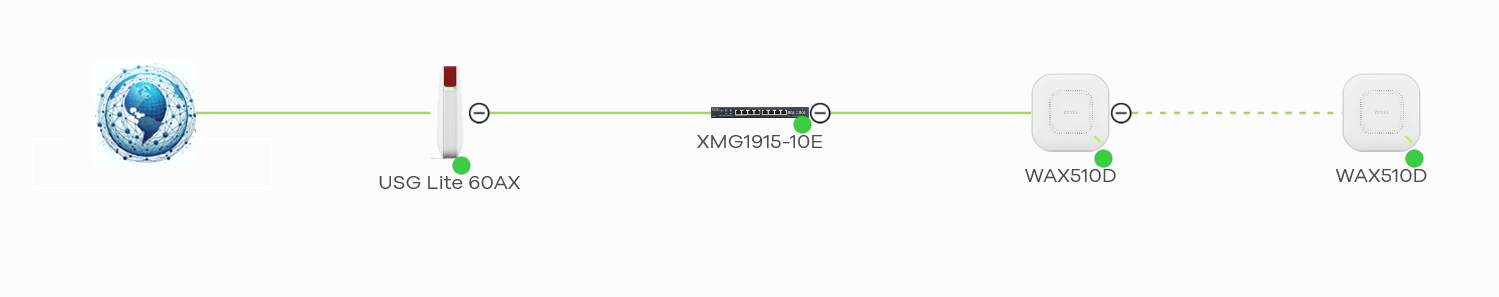

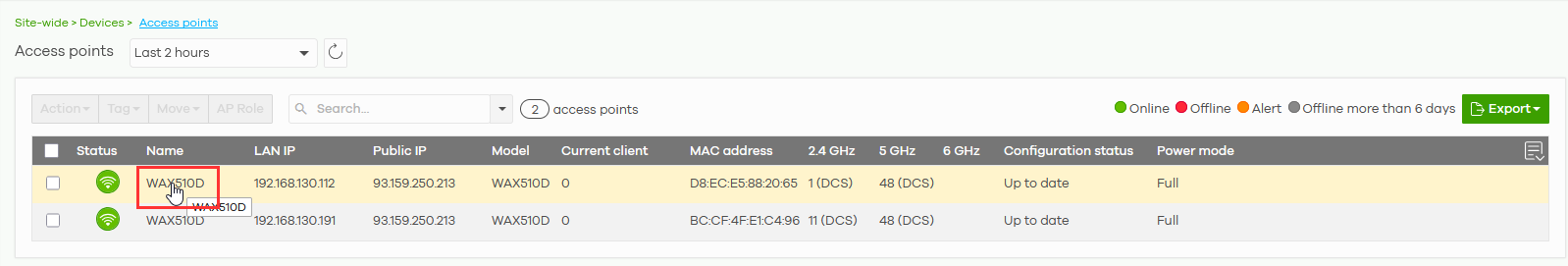

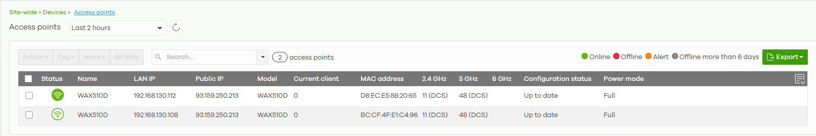

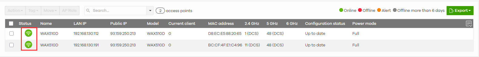

Verification - Successfully connected
  The units should show online and by different symbols:
The hollow-green symbol indicates that the respective AP is working as a repeater AP, while the colour-filled icon indicates that the AP is running as a root AP.

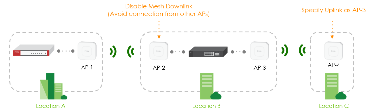

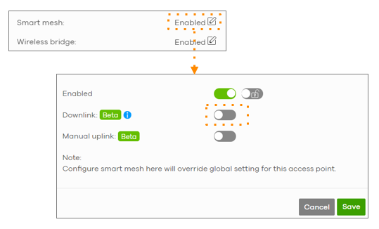

Disable Mesh Downlink
Since Firmware 6.30 we can now disable the Smart-Mesh Downlink on Repeater APs to avoid other Mesh APs siphoning away Bandwidth.
Enabling Downlink on AP-2 means that AP-4 cannot mesh with AP-2.
To deactivate the Downlink, go to:
Site-wide > Devices > Access Point > "Specific AP"
Then edit the Smart-Mesh and disable the Downlink.
Please note that the AP will still be functioning as a Mesh AP.

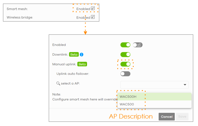

Specify Uplink AP
We can now specify which AP should be used as the main Uplink.
To do so, go to:
Then edit the Smart-Mesh and choose the main root AP for this repeater AP.

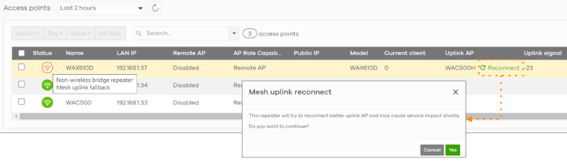

Failover in Smart-Mesh
This function depends on having chosen a specific root AP for this repeater AP (see point 8 above).
When the repeater AP fails to connect to the specified root AP, it will then connect to other available APs to keep the Internet connection up.
The Error status will be displayed on the AP List:
The Administrator can manually trigger a reconnect from the AP status list.

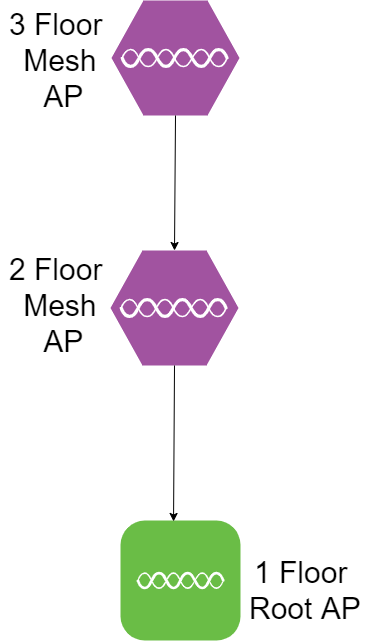

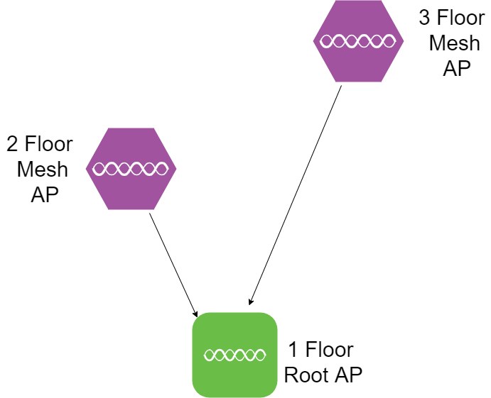

  • Hi,
    at the beginning of the article it is explained that the mesh devices (AP without ethernet) must be within the coverage of the root access point (AP ethernet)
    "Smart Mesh works in a way that out of a multitude of Accesspoints, only one of the Accesspoints remain cabled to the main infrastructure ("root AP"), while the other units can be placed throughout the facility within coverage range of the root AP."
    Subsequently, however, it seems possible to perform the mesh configuration across multiple device
    "4. Things to consider
    Smart Mesh
    • Establish mesh across multiple wireless hops (no limit)"
    So if I have an access point on the 1st floor (AP ethernet), one on the 2nd floor (AP without ethernet), and one on the 3rd floor (AP without ethernet)
    Will the connection follow the following example?
    or the following scheme?
    Thank you
