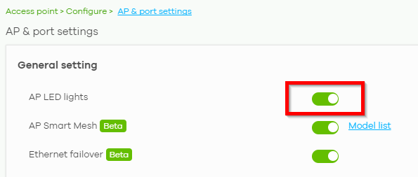

• Disable all lights on all AP's in the site:
Navigate to the following menu to deactivate the AP lights for the entire site:
Site-wide -> Configure -> Access points -> AP & port settings
