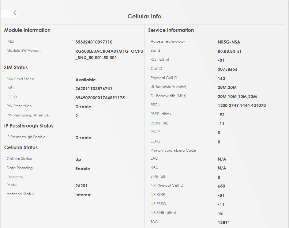

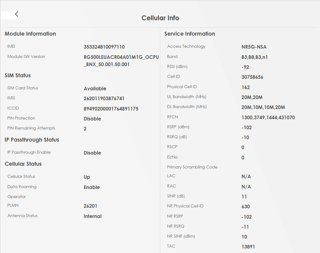

The two screenshots below show the cellular signal statistics of the same Zyxel FWA device placed in two different locations:
  • Center of the room (Screenshot 1)
  • Near a window (Screenshot 2)
Simply moving the device closer to a window led to a noticeable improvement in signal strength and quality:
  • RSRP improved from -102 dBm to -92 dBm
  • NR SINR jumped from 10 dB to 18 dB
  • RSSI increased by 11 dB
This small adjustment significantly enhances the connection’s reliability and speed. It clearly demonstrates that optimal placement—preferably near windows or with line-of-sight to the nearest base station—can greatly improve performance, especially for 5G.
Here's a detailed comparison of the two screenshots for Zyxel FWA cellular signal data:
Parameter Screenshot 1 Screenshot 2 Comparison / Interpretation
RSSI (dBm) -92 -81 Improved in Screenshot 2 (stronger signal).
RSRP (dBm) -102 -92 Improved in Screenshot 2 (stronger signal).
RSRQ (dB) -10 -11 Slightly worse in Screenshot 2 (but within similar range).
SINR (dB) 11 8 Slightly worse in Screenshot 2.
NR RSRP (dBm) -102 -81 Significantly improved in Screenshot 2.
NR RSRQ (dB) -11 -11 Same in both.
NR SINR (dBm) 10 18 Improved in Screenshot 2.
RSSCP / EcNo / Other values Same values (0 or N/A) Same values (0 or N/A) No difference.
Summary:
Screenshot 2 shows a clear improvement in signal strength and quality:
  • Stronger RSSI, RSRP, and NR RSRP
  • Higher NR SINR (better signal clarity)
  • Minor drop in LTE SINR and slightly worse RSRQ, but overall quality is significantly better.
This could result from better antenna placement, less interference, or improved network conditions.
