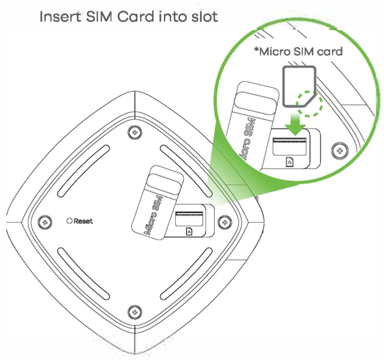

If your Zyxel 5G router fails to detect the SIM card or connect to the network, start by checking the basics.
Some models require the SIM card to be inserted before powering on. Inserting it later may cause detection issues. Also, make sure the SIM card is correctly and fully inserted — improper placement can prevent network registration.
  • Insert the SIM card before powering on the device.
  • Ensure the SIM card is correctly inserted into the Zyxel device.

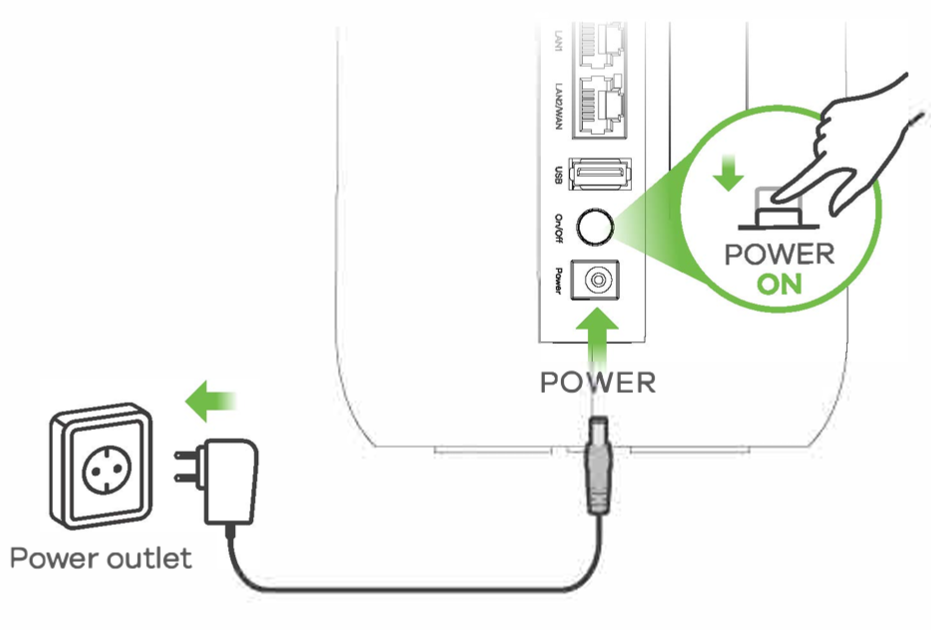

  • Verify that the power adapter is securely connected and powered on the device.
Instructions for the initial startup of the device are available here:
FWA505 FWA510 FWA710

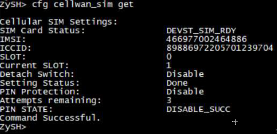

3. Check the SIM status and check if SIM card is locked
On WebGUI, go to Menu > System Monitor > Cellular WAN Status. Console command:  cfg cellwan_sim get to check if

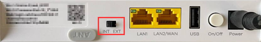

  • Verify the antenna mode selection: If the router is set to external antenna mode but no external antenna is connected, the device will fail to establish a connection with the internet provider. Ensure the correct antenna mode is selected based on your setup.
