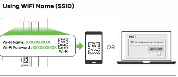

WIFI (SSID) connection  Using WPS Erhernet Cable
Wi-Fi SSID connection method

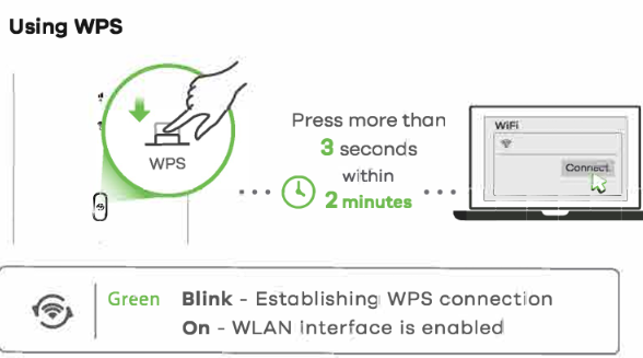

WPS connection method

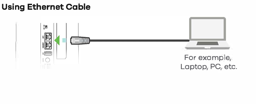

Ethernet cable connection method
To connect to the FWA510, use WPS, select the WiFi SSID manually, or connect an Ethernet cable.

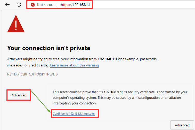

To access the router, open a browser and navigate to 192.168.1.1 (this IP is also listed on the device's sticker or can be found through your computer's network settings).
Browser security warning page

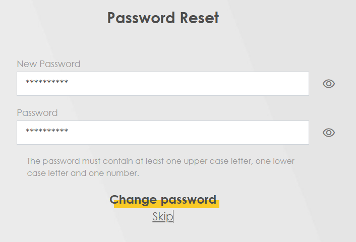

On the first step, the system will ask you to change the default password; this action is mandatory.  Change the password and log in to the device's web GUI with the new password.

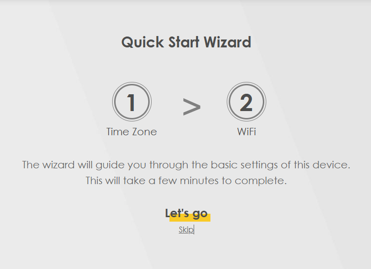

Password reset and quick start wizard

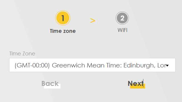

Time zone setup wizard
Next, follow the prompts and use the wizard to perform basic device settings, such as setting the correct time search, renaming the SSID, and changing the Wi-Fi password.
