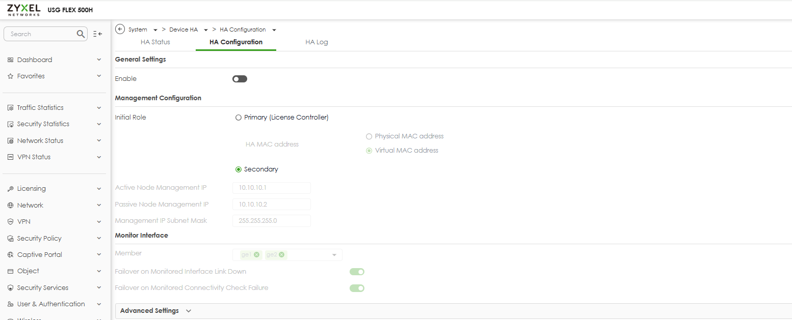

  • On the Primary Device, go to > System >Device HA  > HA Configuration
  • Click Enable HA and set:
  • On the Secondary Device, go to > System >Device HA  > HA Configuration
  • Click Enable HA and set (on a passive device, there is no need to make any HA settings, just activate this function):
