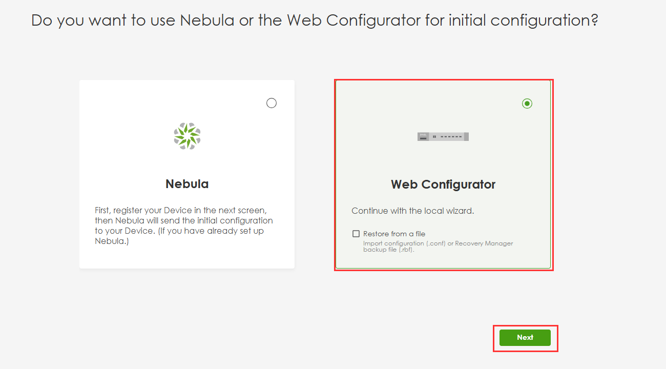

When you first initialize the device, if you plan to use HA Pro, you must select "Web Configurator

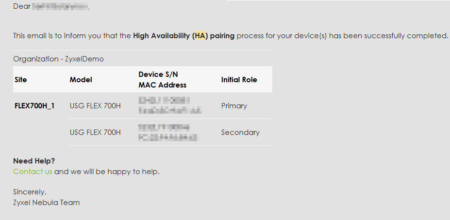

When you log into a Zyxel Device after Device HA pairing, you will see a banner to show if you are logged into the active or passive Zyxel Device.
You will also receive an email notification that the High Availability (HA) pairing process for your device(s) has been completed.
