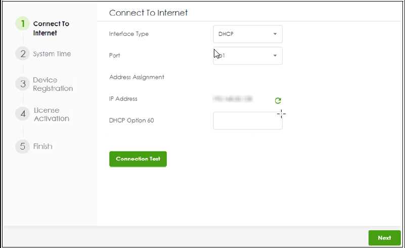

In connecting to the Internet, you can configure a PPPoE connection, DHCP, or a static IP address. However, VLAN tagging configuration may not be available in this step.
If you have a newer version installed on your device, this step will allow you to configure the VLAN tag, as shown below.
