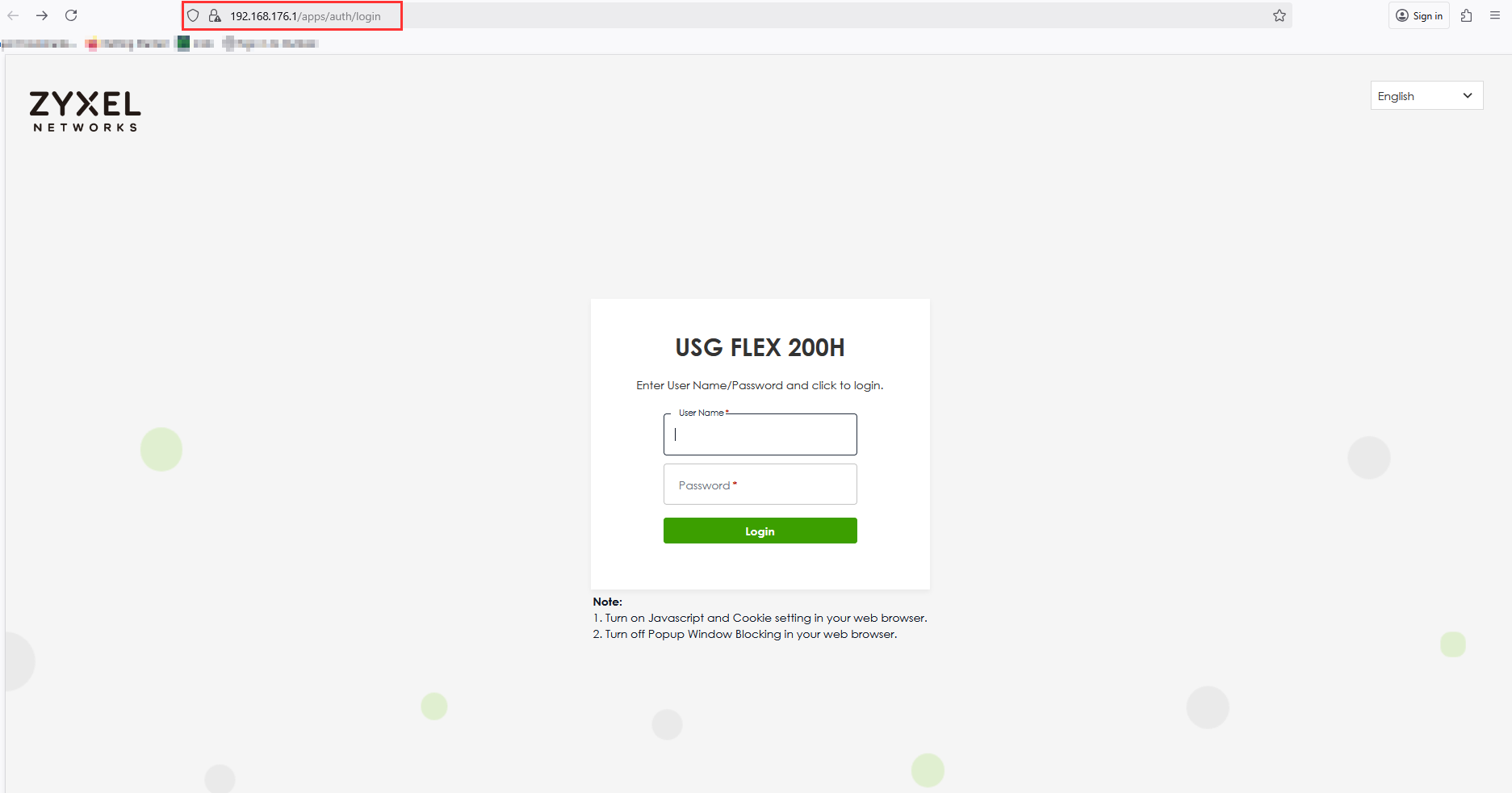

Accessing the WebUI
To access the USG FLEX H web configuration page, open a web browser on your computer (e.g., Internet Explorer, Mozilla Firefox, Google Chrome).  On the address ba,r please type http://192.168.168.1 to access the WebUI. The Login screen appears.
Note: Default login: admin/password, as shown on the device sticker. If no sticker is present, the default password may be 1234.
Note: The value in this field is invalid. It can consist of 4-63 characters. The valid characters are [0-9][a-z][A-Z]['(){}<>^`+/:!*#@&=$\.~%,|;-"]. Space is also not allowed.
Note:  If the default password has been changed, use the new password to log in.  If this is the first time setting up the device and it is not accepting the "1234" password or password, as shown on the device sticker, please press the RESET button on the device (located on the front panel) and hold it down for 10-15 seconds

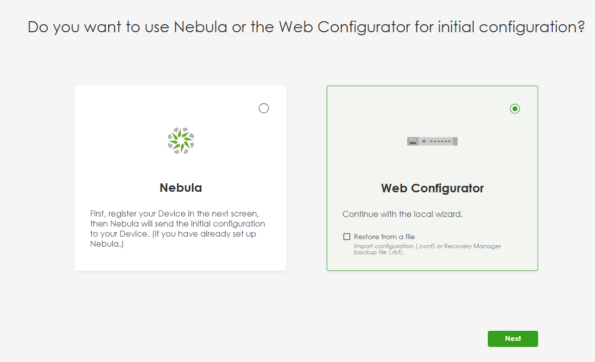

WAN Setup Wizard
  • Connect to Internet step - "The initial setup wizard will appear the first time you log in to the USG FLEX H WebUI. Simply follow the prompts to configure the WAN port connection.  In the first step, you can select the interface type, DHCP, Static, PPPoE, and specify the WAN port, which can be Port P1 or P2.
Click 'Next' to proceed to the next step.

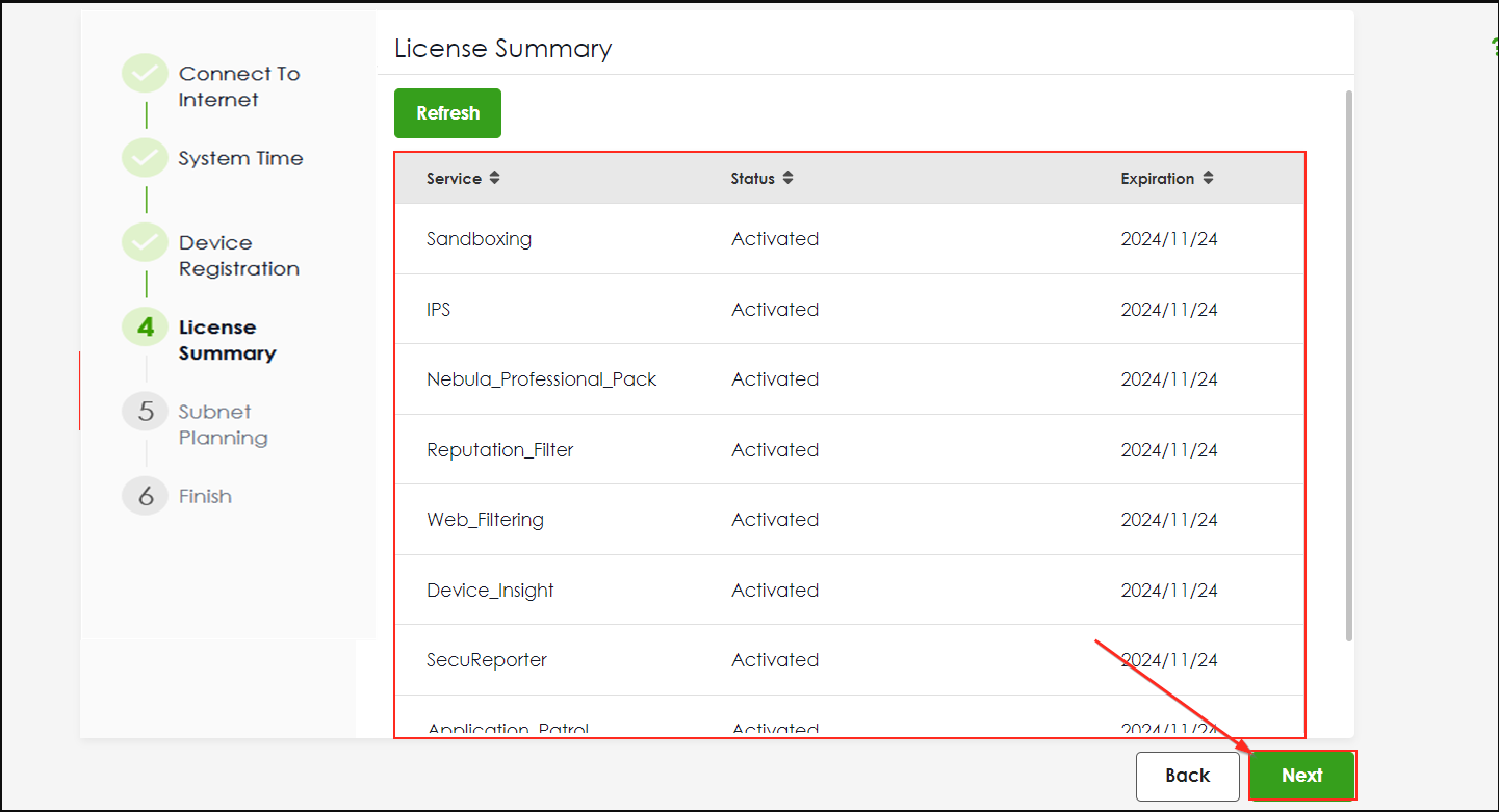

License Summary
  • License Summary step - the next step automatically activates all services to which you have a subscription.
  • Click 'Next' to proceed to the next step.

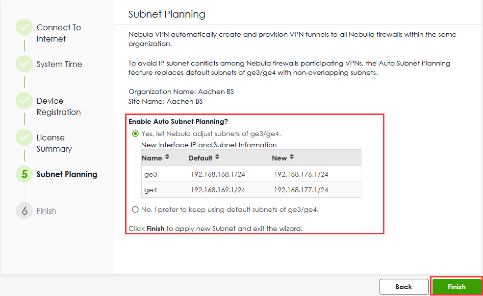

Auto Subnet Planning Setup
  • At this step, you can choose whether Nebula should automatically update the subnets for interfaces ge3 and ge4 to avoid IP conflicts between VPN devices in the same organisation.
  • Options:
  • Yes – Nebula will assign new subnets:
    • ge3: from 192.168.168.1/24 → 192.168.176.1/24
    • ge4: from 192.168.169.1/24 → 192.168.177.1/24
  • No – Keep the current default subnets.
  • Click Finish to apply the selected settings and complete the wizard.

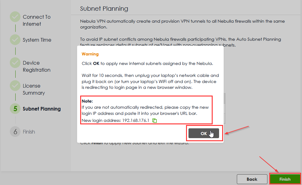

After Clicking "Finish"
  1. Click OK to apply new subnets.
  2. Wait 10 seconds (sometimes it takes longer, just wait), then reconnect your cable or Wi-Fi.
  3. You will be redirected to the new login page.
    • If not, open it 192.168.176.1 manually in your browser.
  4. Click "Connect to New Network" to continue.
Please note that the device's IP address has changed.
Finish step - Click Finish to exit the wizard.
