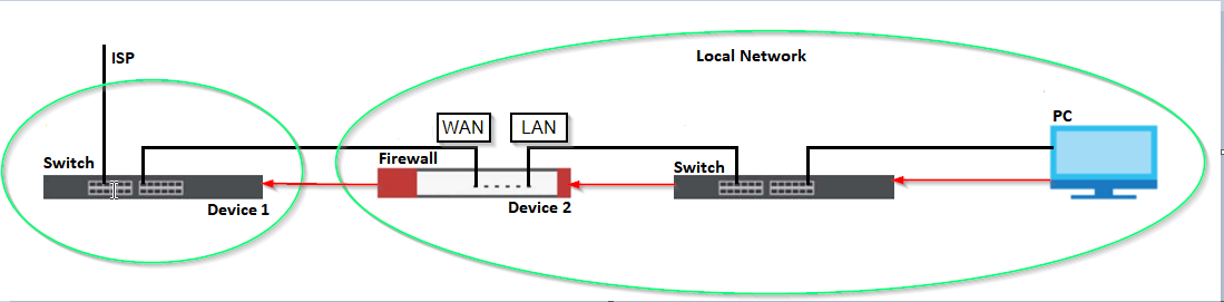

This article shows how to access from a LAN to a Switch in front of the Firewall that isn't part of that LAN. Access will be configured by adding the same VLAN to the WAN interface of the Firewall and Switch port in front of the Firewall [USG FLEX, ATP, VPN Series]. The control interface of the Switch, which is located in front of the Firewall, will be assigned an IP address from the created VLAN.
All settings in this article will be made on "Device1" and "Device2", as shown in the figure below. All other devices are present for illustrative purposes.
To access the Switch through the WAN, you need to configure a VLAN on the Firewall(Device2), and the same VLAN must be configured on the Switch(Device1) in front of the Firewall(Device2). Also, the Switch's management interface (Device1) should be assigned the IP of the created VLAN. Then users from the Local Network can access the Switch(Device1).
