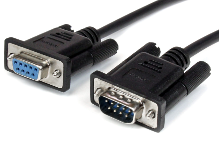

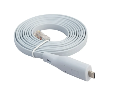

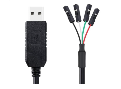

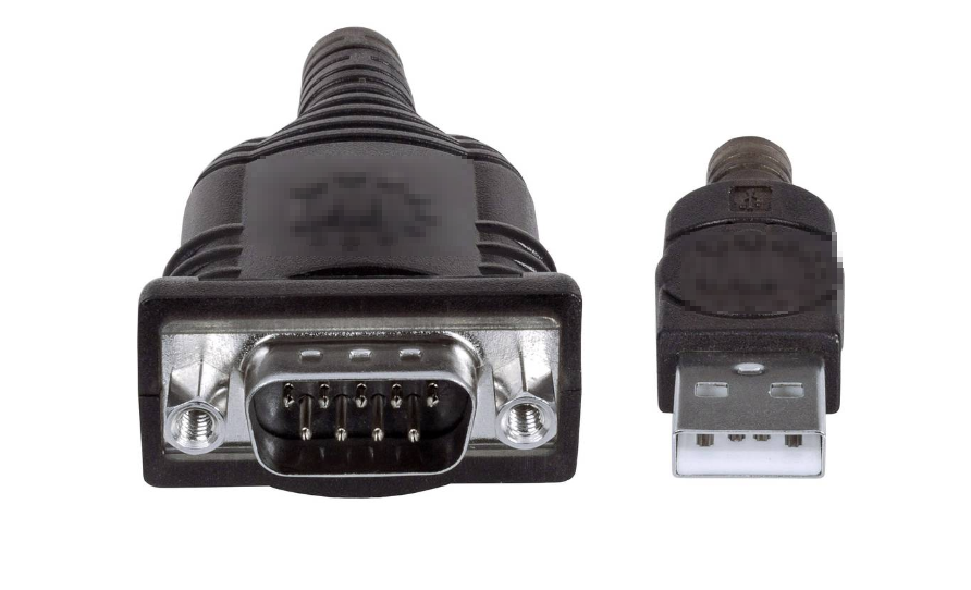

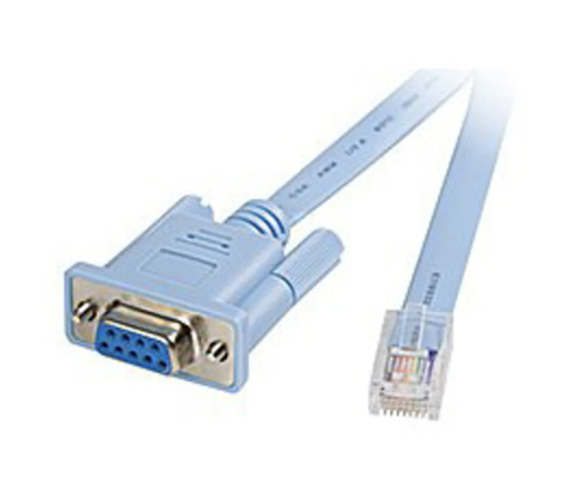

Console Cable
USB-to-RS232 RJ-45-to-RS232 USB Typ C-to-RJ-45 USB-to-TTL db9-rs232
In general, all our firewalls support RJ-45-to-RS232, and USB or USB Type-C-to-RJ-45 cables, depending on the model. Certain switch models feature RS232, USB Type-C-to-RJ-45, or USB-to-TTL connector,s depending on the model. For access points, a USB-to-TTL connector is typically used. However, please have a look at the specific documentation for your device to confirm compatibility and requirements.

  • RJ-45 to DB-9 Rollover Cable -> Change Console Cable pin-out to general
* USG FLEX H Console Cable is not compatible with ATP/USG FLEX Series Console cable

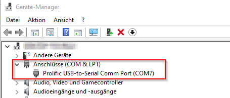

Cable driver
Eventually, you might have to install additional drivers packaged with the USB-to-RS232 cable or install generic drivers for the application. Once this is done, within your device manager, in most cases, you can see a "COM" interface listed:

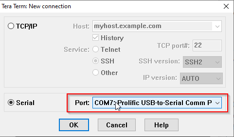

Connecting with TeraTerm

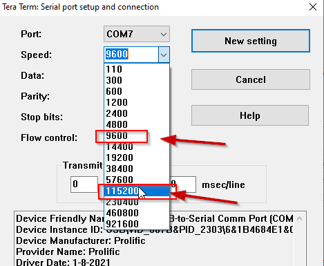

On TeraTerm, you will be prompted to choose the input - select the serial input and select the COM interface listed previously in the device manager. Make then sure to enter the menu Setup > Serial port.
In this menu, you can set different things regarding the serial port communication. We are, however, only interested in the speed; the rest stays as per default:

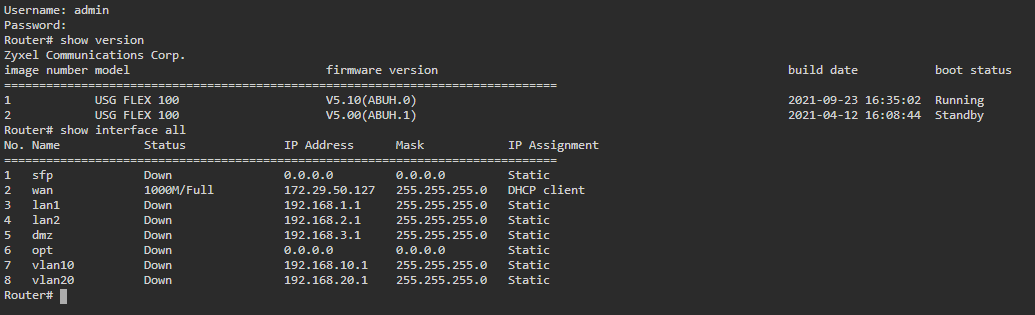

The speed is measured in baud, and the speed is also referred to as baud rate. A lot of our switches have a default baud rate of 9600, while all firewalls out of our portfolio and access points have a baud rate of 115200. Choose 115200 and click on "New Setting" to save the settings, and back in the Console menu (the black screen), press any button to reinitialize communication with the new baud rate. You then can enter your firewalls username and password (password will not show any character when you type in, so simply carry on typing and press "Enter" once you are done). Afterwards, you should be logged into the unit, which will show via
You can start entering different CLI commands, which can be read within the CLI reference guide, available via https://download.zyxel.com.

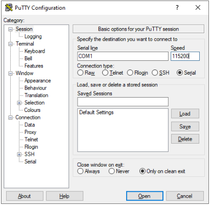

CLI-access via Console Cable (using PuTTY)

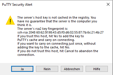

Download puTTY via the above link and start the application. In the Hostname field, enter the IP-Address of the Firewall (usually the LAN1 interface, which by default is 192.168.1.1). Leave the port as 22 and also as an access method, leave SSH as it is by default and confirm by clicking on the "Open"-Button:

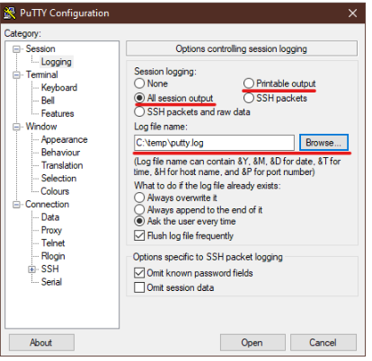

  • Open Session -> Logging and adjust the logging settings to get an output of our entered commands. You will most likely if the certificate of the firewall has not been changed by you, receive this warning message.
The reason for this is that the firewall uses self-created key fingerprints as well as self-signed certificates. But this is no reason for concern; allow to proceed by clicking "Yes", "Accept", or similar and proceed. You then should be able to log in as admin-username and the password of the admin account (by default 1234) and should be again showing successful login by seeing this line:

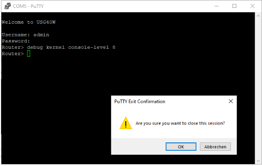

Debug the Firewall USG FLEX/ATP/VPN
Enter your respective commands, enter the following command for high profile debug logs:
debug kernel console-level 8

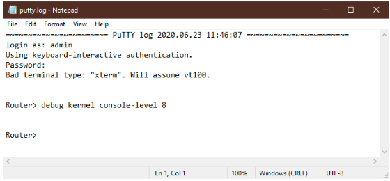

  • Leave the session open until you have logged the respective traffic (in this example, we unfortunately had no issues happening, therefore no log is created). After you have captured / reproduced the issue and the debug logs have been generated, you can  analyze/investigate and close the PuTTY-session:
  • Now you can access the text-file, which you have created and it will show you all entered commands and results:
