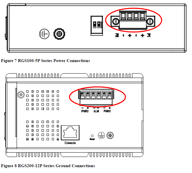

1.
 RGS Series must be properly grounded for optimum system performance.
Please refer to the user manual on page 16 ff.

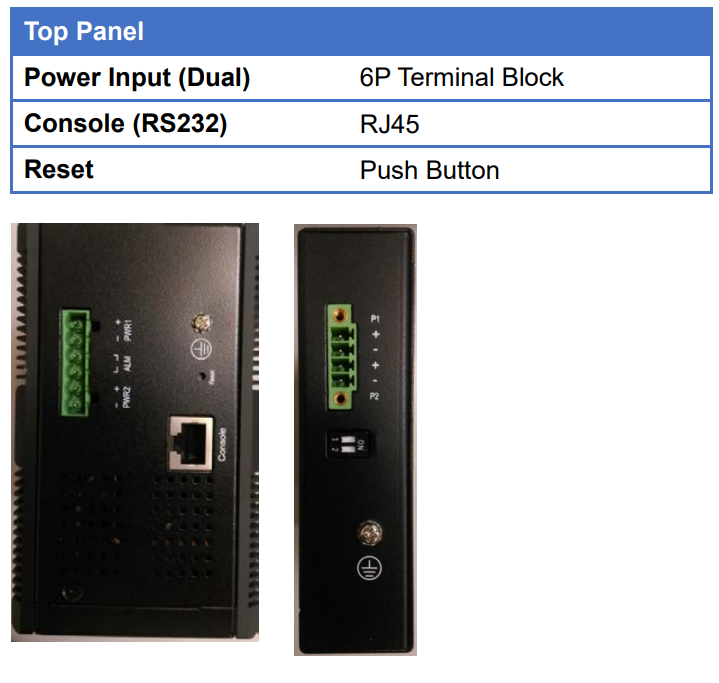

The DC Power interface is a 6-pin terminal block with polarity signs in the top panel. The RGS200-12P can be powered from 2 power suppl (input range 12V - 58 V). The DC power connector is a 6-pin terminal block; there is alarm contact on the middle terminal block.
The DC power should be connected to a well-fused power supply.
