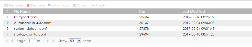

Configuration files list page
  • System-default.conf
    • If there is no startup-config.conf when you (re-)start the ZyWALL/USG/ATP, the device uses the system-default.conf configuration file with the factory default settings.
  • Startup-config.conf
    • The startup-config.conf file is the configuration file that your device is currently using.
      If there is a startup-config.conf, it is first checked for errors. If there are no errors, the device uses it and copies it to the lastgood.conf configuration file as a backup file.
    • If there is an error, the device generates a log and copies the startup-config.conf configuration to the startup-config-bad.conf configuration file and tries the existing lastgood.conf configuration file.
    • If there isn’t a lastgood.conf configuration file or it also has an error, the ZyWALL/USG/VPN applies the system-default.conf configuration file.
  • %customerchoose%.conf:
    • At any time, especially before doing major configuration changes, it is recommended to safe the current configuration. This can be done by copying the startup-config.conf and rename the copy to your preferred name.
  • autobackup-*.conf
    • before your device upgrades to a new firmware, the startup-config is copied to the autobackup-*.conf

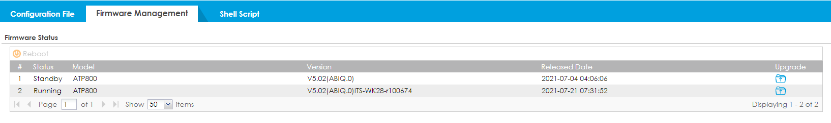

Our Gateway series devices (Zywall, USG, USG FLEX, ATP, VPN) count with two partitions on which different firmware version can be installed, having one partition as the Running and the other Partition as Standby:
Maintenance > File Manager > Firmware Management
Firmware partition status page
"Running" status means the device has now boot up using that partition (partition #2 in the image above), and "Standby" (partition #1) means the other partition not being used at the moment.
As the partitions can have different firmware version, each partition has its own set of configuration files. While checking the "Configuration File" page you are actually seeing the configuration files of the running partition.
