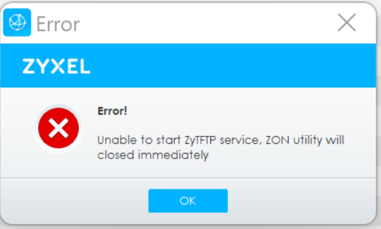

Note: Windows could not start the ZyTftpd32 service edition service on the local computer. Error 193: 0xc1, Unable to start ZyTFTP service, ZON utility will close immediately, TFTP port 69 is occupied, please close it and restart ZON utility

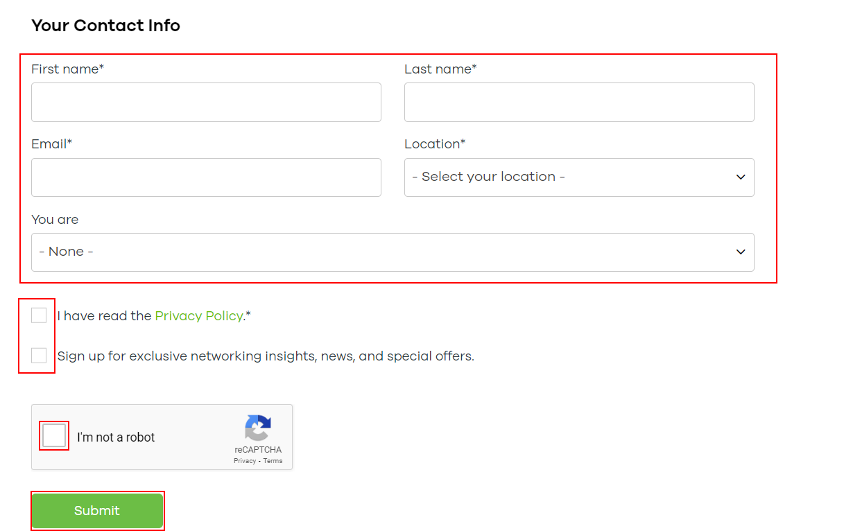

Follow the link and drop it to the bottom of the page. At the end of the page, you will see "Your Contact Info". Fill in all the required information and click "Submit". Next, you will receive an email to the address specified when filling out the form with a link to download the ZON application.

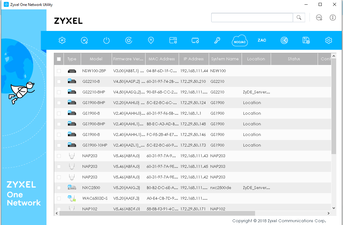

How to use the ZON Utility Tool
| ICON | Description |
| 1. IP Configuration | Change the selected device's IP address |
| 2. Renew IP Address | Update a DHCP-assigned dynamic IP address |
| 3. Reboot Device | Use the icon to restart the selected devices. |
| 4. Reset Configuration to Default | Reload the factory-default configuration file. You will lose all previous configurations |
| 5. Locator LED | Locate the selected device by causing its locator LED to blink. |
| 6. Web GUI | Access the selected device Web Configurator from your browser. |
| 7. Firmware Upgrade | Upgrade new firmware to selected device of the same model. Make sure you have downloaded the firmware from Zyxel website to your computer and unzipped it in advance. |
| 8. Change Password | Change admin password of the selected device. You must know the current admin password before changing. |
| 9. Configure NCC Discovery | Enable or disable the Nebula Control Center (NCC) discovery feature on selected device. If it's enabled, it will try to connect to NCC. It needs to be registered in Nebula and you must have internet access. |
| 10. ZAC | Run the Zyxel AP Configurator of the selected AP |
| 11. Clear and Rescan | Clear the list and discover all devices on the connected network (of the selected network adapter) again. |
| 12. Save configuration | Save configuration changes to permanent memory on a selected device. |
| 13. Settings | Select a network adapter for the computer on which ZON is installed. |

- Windows could not start the ZyTftpd32 service
If you get this error, you might not have administrator rights to your PC. Please check that Zytftpd32 service is running and that you have admin rights on your PC.
- Make sure ZyTftpd32_svc is running
Please start the ZON utility tool as an administrator on your PC, make sure that the service in Windows called "ZyTftpd32_svc" is running:
