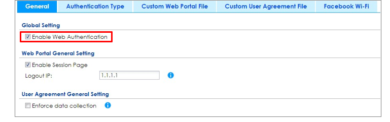

- First, enable web authentication through the ZyWALL/USG’s web GUI. Go to Configuration > Web Authentication > General screen’s Global Setting section. Select the Enable Web Authentication check box.

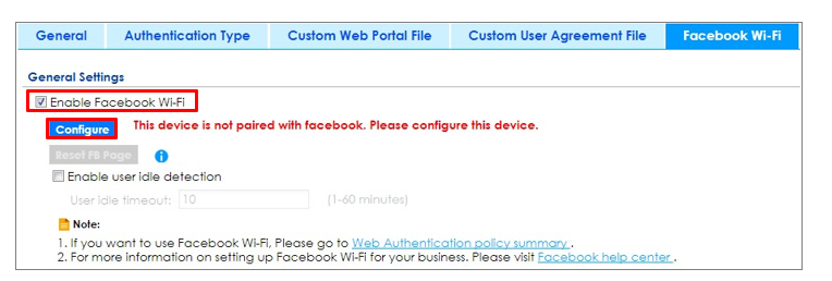

- Enable Facebook Wi-Fi and pair up with your page. Go to Configuration > Web Authentication > Facebook Wi-Fi screen’s Global Setting section. Select the Enable Facebook Wi-Fi check box and click Configure.

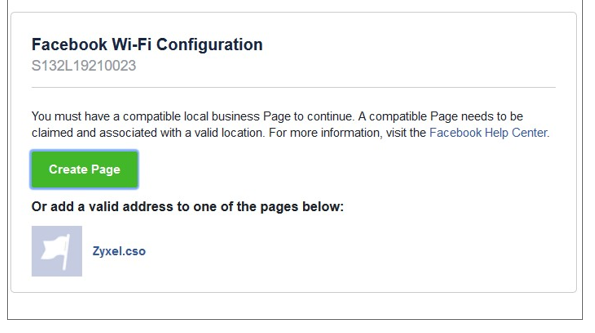

- Click the Configure button to go to Facebook. Login your Facebook account on the browser before continuing with the steps below. You can click Create Page or select an existing page to pair up with the ZyWALL/USG.
- After the device is successfully paired up with Facebook, this Configure button functions as a shortcut to Facebook’s Wi-Fi settings screen.

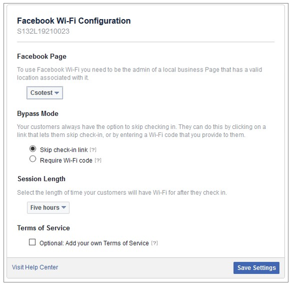

You can configure the following:
Bypass Mode: to allow users to skip check-in for Wi-Fi access.
Session Length: sets how long the users can have Wi-Fi access.
Add your own Terms of Service.
For more information on this screen, please contact Facebook support.

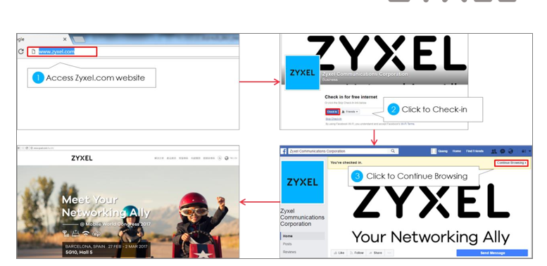

2. Test the Result
Connect to Wi-Fi and the check-in process should be like this:
