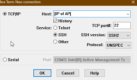

1. Connection via SSH
Use Putty or TeraTerm to access the AP via an ssh session or console connection:

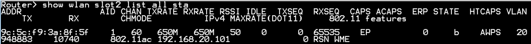

2. Check Station
Check if the station is connected.
Router> show wlan slot1 list all sta --------for 2.4G clients
Router> show wlan slot2 list all sta ---------for 5G clients

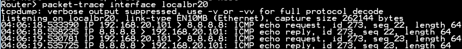

3. Packet Trace
Confirm that the AP receives the packets from the station. Perform a ping to 8.8.8.8 from the station. You can see the packet flow displayed like the following.
Router> packet-trace interface localbr20
