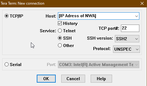

Log in to the device with Putty or Tera Term via SSH:
Type the following command:
>set wlan country enable
>write
>exit
