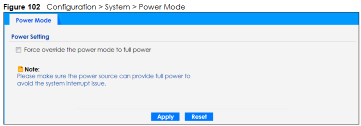

What could happen if I force power mode?
If the WAX650S is forcing the full power mode, the AP will use the PoE power that it needs, which means that it will utilize max throughput no matter if it has the PoE needed for it or not.
Note!
If the 802.11at can't deliver enough power for the WAX650S, then it could begin to restart itself.
