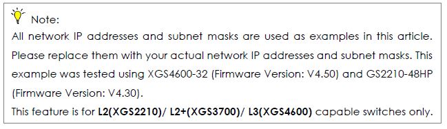

Note: All network IP addresses and subnet masks are used as examples in this article. Please replace them with your actual network IP addresses and subnet masks. This example was tested using XGS3800-28 (Firmware Version: V4.80) and GS2220-50HP (Firmware Version: V4.80).

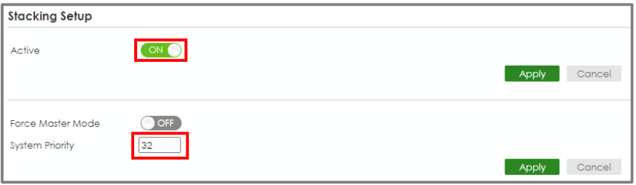

Enter the web GUI and go to Menu > System > Stacking > Stacking Setup. Key in the system priority (The higher the number is, the higher priority it is to become a master) and click “Apply”. Enable the Active setting and click “Apply”.
Switch-1 will reboot.

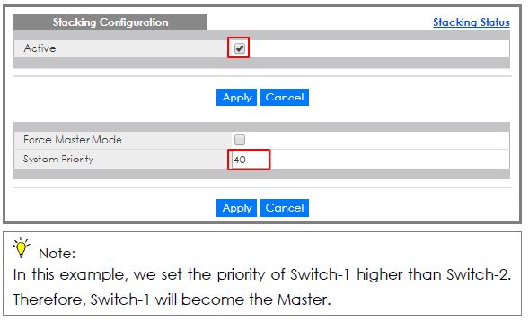

Note: In this example, we set the priority of Switch-1 higher than Switch-2. Therefore, Switch-1 will become the Master.

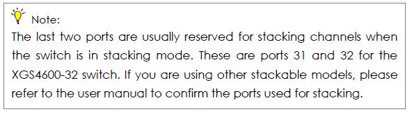

Note: The last four ports are usually reserved for stacking channels when the switch is in stacking mode. These are ports 25, 26, 27, and 28 for the XS3800-28 switch. If you are using other stackable models, please refer to the user manual to confirm the ports used for stacking.

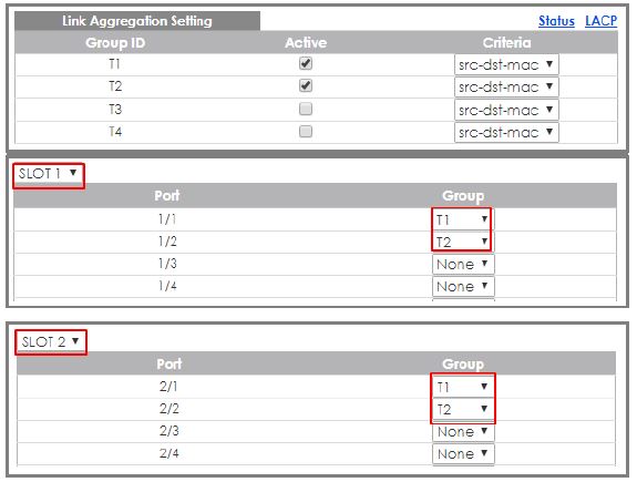

Enter web GUI and go to Menu > Port > Link Aggregation > Link Aggregation Setting. Active T1 and T2. Select SLOT 1 and set the Group of port 1/1 and 1/2 as T1 and T2, respectively.
Click “Apply”.
Select SLOT 2 and set the Group of port 2/1 and 2/2 as T1 and T2 respectively. Click “Apply”.

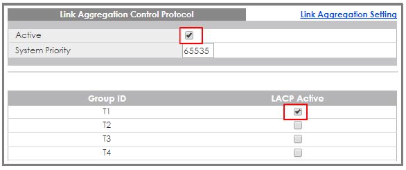

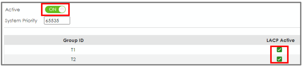

Set the Control Protocol
Go to Menu > Port > Link Aggregation > Link Aggregation Control Protocol. Check the “Active” box, as well as for T1 and T2.

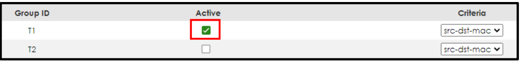

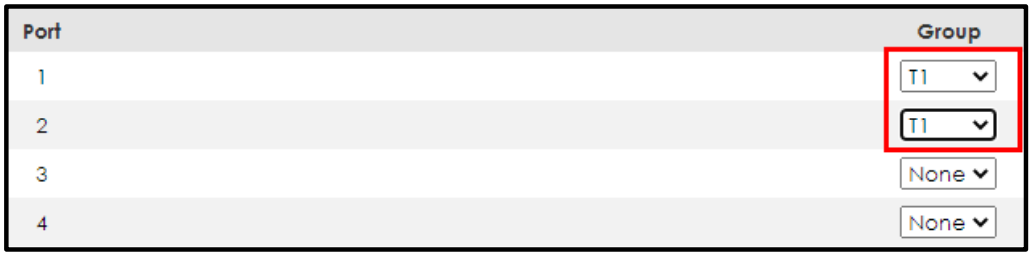

1 Go to Menu > Port > Link Aggregation > Link Aggregation setting. (If you are using V4.70 firmware, please go to Menu > Advanced Application > Link Aggregation > Link Aggregation Setting). Check the Active box for T1 and select the port 1 and 2 as Group T1.
Click “Apply”.

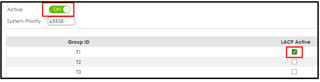

3 Go to Menu > Port > Link Aggregation > Link Aggregation Control Protocol. (If you are using V4.70 firmware, please go to Menu > Advanced Application > Link Aggregation > Link Aggregation Setting >LACP)
Check the “Active” box, as well as for T1.

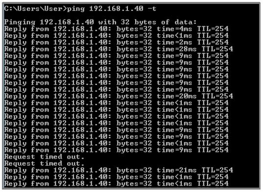

2 Use PC to ping the Server (192.168.1.40). After few times of ping, try to shut down Switch-1 (Master down). The ping will display “timed out” a few times and then ping will be successful again when Switch-2 (Backup) becomes the new Master.

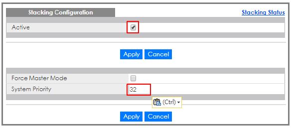

- Set up Switch-1: Enter the web GUI and go to Menu > Basic Setting > Stacking > Configuration. Key in the system priority (The higher the number is, the higher priority it is to become a master) and click “Apply”. Check “Active” and click “Apply”. Switch-1 will reboot.
- Set up Switch-2: Enter the web GUI and go to Menu > Basic Setting > Stacking > Configuration. Key in the system priority (The higher the number is, the higher priority it is to become a master) and click “Apply”. Check “Active” and click “Apply”. Switch-2 will reboot.

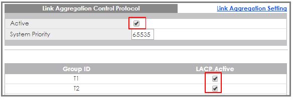

- Go to Menu > Advanced Application > Link Aggregation > Link Aggregation Setting >LACP. Check the “Active” box, as well as for T1 and T2.

- Use PC to ping the Server (192.168.1.40). After few times of ping, try to shut down Switch-1 (Master down). The ping will display “timed out” a few times and then ping will be successful again when Switch-2 (Backup) becomes the new Master.
