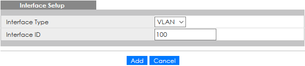

2. Go to Basic Setting > Interface Setup and create VLAN100

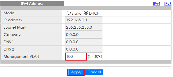

3. Enable the DHCPv6 Client, if you have an DHCPv6 server. But for Management purposes, we suggest to configure static IPv6 address. Disable the Auto Configuration then input the IPv6 address and IPv6 gateway. Click "Apply" to save the configuration.
Configuration > System > IP > IPv6
4. IPv4/6 management VLAN settings is located in the same place. After changing to VLAN100 both IPv4 & IPv6 will be on management VLAN100. Click "Apply" to save the configuration.
