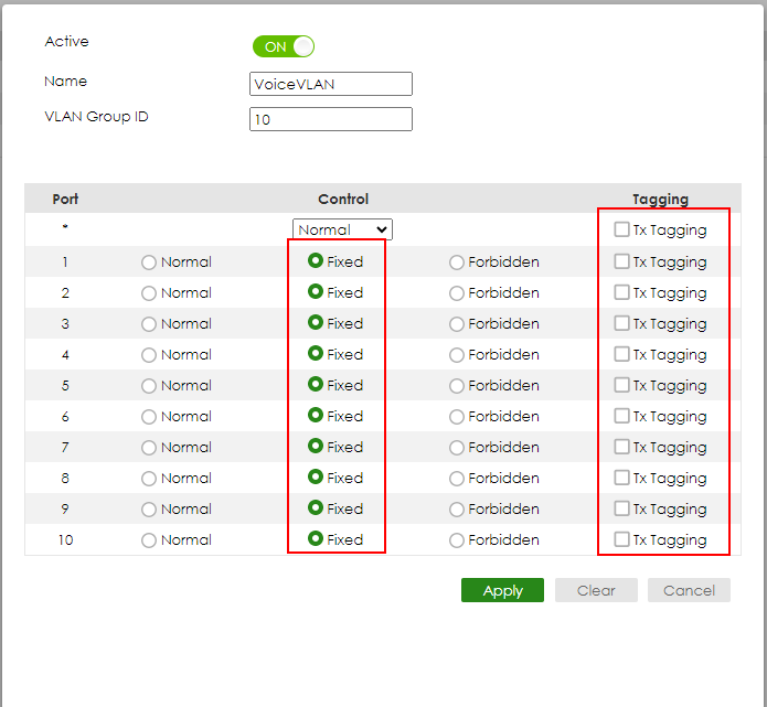

1.Configuration (Create VLAN interfaces)
Create a VLAN for voice packets transmission, select ports which are connected to IP phone, unselect Tx tagging as to save efforts of configuring VLAN on each phone.
Navigate to:
SWITCHING > VLAN > VLAN Setup > Static VLAN > Add/EditCreate another VLAN for data packets, select member ports, unselect Tx tagging.
On the uplink port enable Tx tagging to transmit packets with VLAN tags

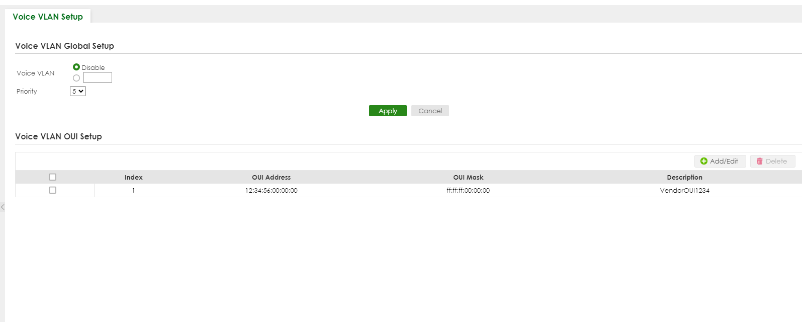

After setting PVID for data packets, next step is to configure “Voice VLAN” feature for the switch to identify the voice packets.
2.Configure Voice VLAN
Configure Voice VLAN number and priority to prioritize the voice packets. The Voice VLAN number should be the same as the VLAN number created earlier for voice service packets.

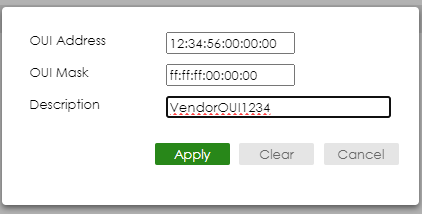

Specify the OUI addresses. OUI are the first 3 bytes of a MAC address that represents the vendor. By specifying the IP phone MAC address, the switch can identify voice traffic accordingly. Zyxel switch supports up to 6 vendor OUIs.
Navigate to:
SWITCHING > VLAN > Voice VLAN SetupClick Add/Edit:
