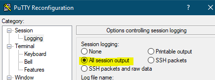

If you only have access via Console/CLI, please save the session output into a file.
Here is an example from Putty:

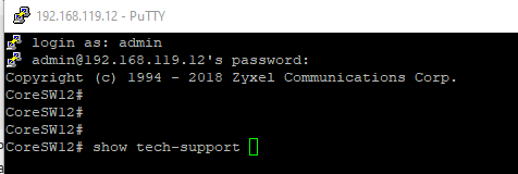

Login and use command:
show tech-support
This can take up to 5 minutes. Depending on your configuration. Please go to the destination where this file was saved and provide this file to us.
