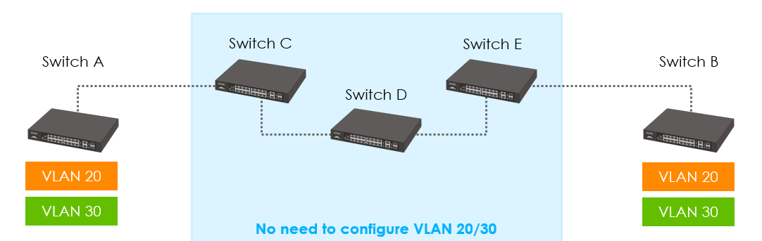

Enable VLAN Trunking on a port to allow frames belonging to unknown VLAN groups to pass through that port. This is useful if you want to setup VLAN groups on end devices without having to configure the same VLAN groups on intermediary devices.
Suppose you want to create VLAN 20 and VLAN 30 on Switch A and Switch B. Without VLAN Trunking, you must configure VLAN 20 and VLAN 30 on all intermediary Switches C, D and E; otherwise they will drop frames with unknown VLAN group tags. However, with VLAN Trunking enabled on port(s) in each intermediary switch you only need to create VLAN groups in the end Switches(A and B). C, D and E automatically allow frames with VLAN tags 20 and 30 (VLAN groups that are unknown to those switches) to pass through their VLAN trunking port(s).

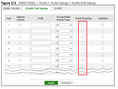

Old GUI:
Advanced Application > VLAN > VLAN Configuration > VLAN Port Setup
New GUI:
SWITCHING > VLAN > VLAN Setup > VLAN Port Setup
Ingress check: The Switch discards incoming frames on a port for VLANs that do not include this port in its member set.
GVRP (GARP VLAN Registration Protocol): is a registration protocol that defines a way for switches to register necessary VLAN members on ports across the network.
VLAN Trunking: Enable VLAN Trunking on ports connected to other switches or routers (but not ports directly connected to end users) to allow frames belonging to unknown VLAN groups to pass through the Switch.
Isolation: Allow this port to communicate only with the CPU management port and the ports on which the isolation feature is not enabled.
