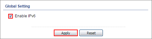

1.Enable the IPv6 on the ZyWALL/USG
In the ZyWALL/USG, go to CONFIGURATION > System > IPv6 > Global Setting
- Select Enable IPv6 and click Apply at the bottom of the screen.
Configuration > System > IPv6 > Global Setting

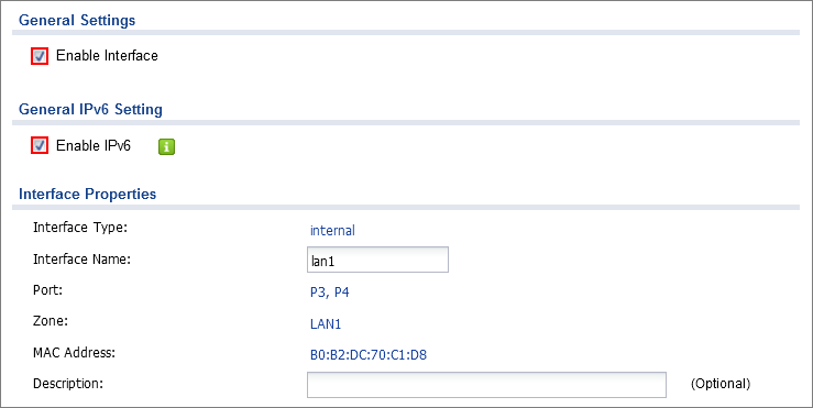

3. Set Up the LAN IPv6 Interface on the ZyWALL/USG
In the ZyWALL/USG, go to CONFIGURATION > Network > Interface > Ethernet > lan1.
- Select Enable Interface and Enable IPv6. Select Enable Stateless Address Auto-configuration (SLAAC).
- Select Enable Router Advertisement and click Add to configure a network prefix for the LAN1 (2002:1111:1111:1111::/64 in this example).
- Click OK.
Configuration > Network > Interface > Ethernet > lan1 > General Settings

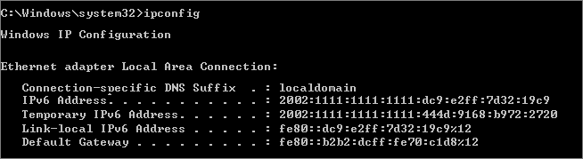

4.Test the Result
Connect a computer to the ZyWALL/USG’s LAN1.
- Enable IPv6 support on your computer. In Windows XP, you need to use the IPv6 install command in a Command Prompt. In Windows 7, IPv6 is supported by default. You can enable IPv6 in the Control Panel > Network and Sharing Center > Local Area Connection screen
- Your computer should get an IPv6 IP address (starting with 2002:1111:1111:1111: for this example) from the ZyWALL/USG.
Windows > cmd > ipconfig
