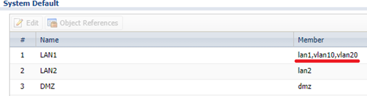

- Check if the VLANs are in the same Zone
Go to Configuration > Object > Zone > System Default looks if two or more VLANs are in the same zone like this.

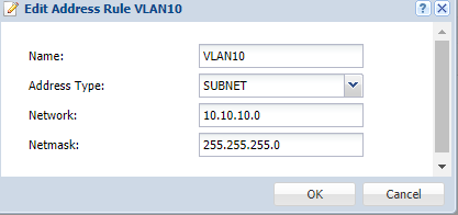

Go to Configuration > Object > Address/Geo IP > Address. Now create for every VLAN an object. Click Add and give the rule a name (in this example VLAN10). Set Address Type to SUBNET and type in the VLANs IP address and mask. Repeat this step for ALL your VLANs.

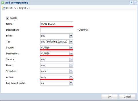

Go to Configuration > Security Policy > Policy Control > IPv4 Configuration. Now set up the following steps: Click on Add and give the rule a name like VLAN_BLOCK or something.
As an example: To block the traffic between VLAN10 and VLAN20 set the source to the created VLAN10 and the destination to VLAN 20. The action of the rule is “deny”.

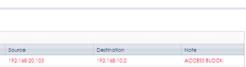

When you now try to ping a device from VLAN10 to VLAN20 the Policy Control has rejected it. When you go to Monitor > Log, you can see here that the access got blocked.
