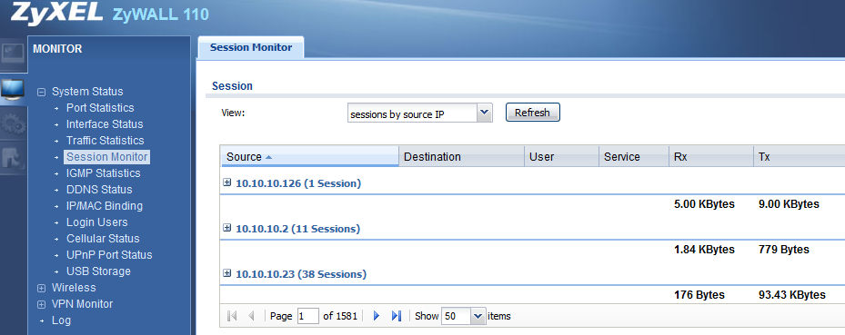

In the ZyWALL web configurator, the following situation can sometimes be observed (the number of active sessions is almost at its maximum, with only a few computers connected to the device):
Go to the Monitor > System Status > Session Monitor menu and see which computers are connected (in our example, only 3 clients are connected to the ZyWALL 110).
Now you need to figure out which computer opens so many sessions:
