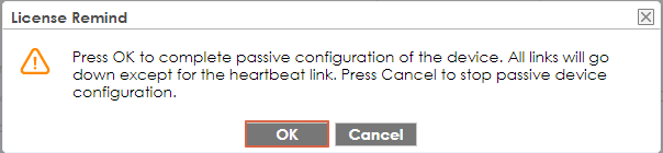

Please go to the following settings and tick "Enable Configuration Provisioning From Active Device" and "Enable Device HA", then press Apply:
Configuration > Device HA > Device HA Pro
Press OK to complete the configuration of the passive device.

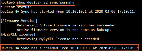

The sync status can also be checked via the console.
commands:
# show device-ha2 device-status
# show device-ha2 passive device-status
# show device-ha2 sync summary
Verification
You can check if everything is working in the log of the device HA status.
You should see the following messages when the configuration was successful:
