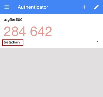

Register the admin account to Google Authenticator.
Open the Google Authenticator App and scan the barcode on Web GUI.
Enter the token code displayed on the Google Authenticator and click “Verify code and finish” for verification.

1. Login with the admin account "testadmin".
2. A pop-up window appears for administrator to enter the verification code.
3. Enter the code shown on Google Authenticator and click "Verify". You can also enter the backup code if you don’t have mobile device on hand.
4. Authorize with username, password and the token code successfully.
