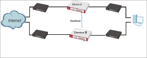

Topo (DeviceHA-Pro)
In Device HA Pro, a “heartbeat link” is added for monitoring the interface status and synchronizing settings.
The behavior of the Device HA Pro includes a heartbeat link to monitor the “activate” device’s interface status. If one of the monitored interfaces is dead or fails, the “passive” device’s status will become “activate”. (This means only 1 device’s status can be “activate” at a time.)
Heartbeat Link
The heartbeat port is a new physical port on the device (fix in Firmware last Port of supported HA-Pro device). After you have enabled Device HA Pro, the devices will transmit multicast packets (UDP 694) to check each device’s status. When the passive device is working properly, the system LED light will be on. Only the heartbeat port’s LED light can be on.

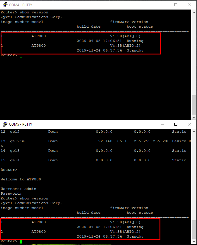

- On Device B, the running firmware version must be the same as Device A.
- On Device B, the partition of running firmware must be in the same position as Device A.

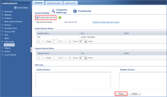

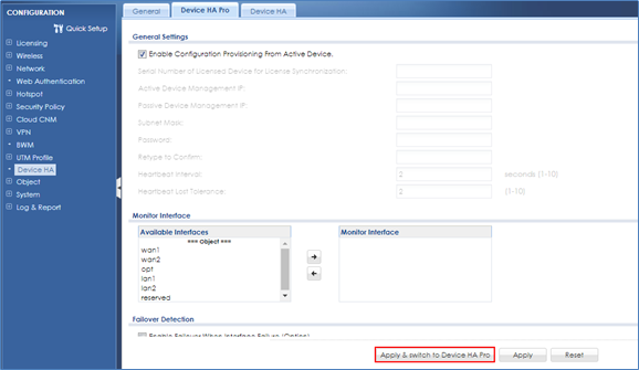

Go to Configuration> Device HA>Device HA-Pro
Then Progress configure HA setting
Note! Device Management IP and local subnets cannot be the same!

- The running firmware version must be the same as the first device
- The running firmware partition must the same position as the first device
The running partition of the first device is partition 1, then the running partition of the second device must be partition 1.
- Configure HA-pro settings on GUI (2 buttons click only)
On the passive device first:
On the active device second:

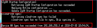

# show device-ha2 sync summary
It’s very important that [ZySH Startup Configuration] status should be successful without any issue and the last line the status of Device HA Sync also successful.

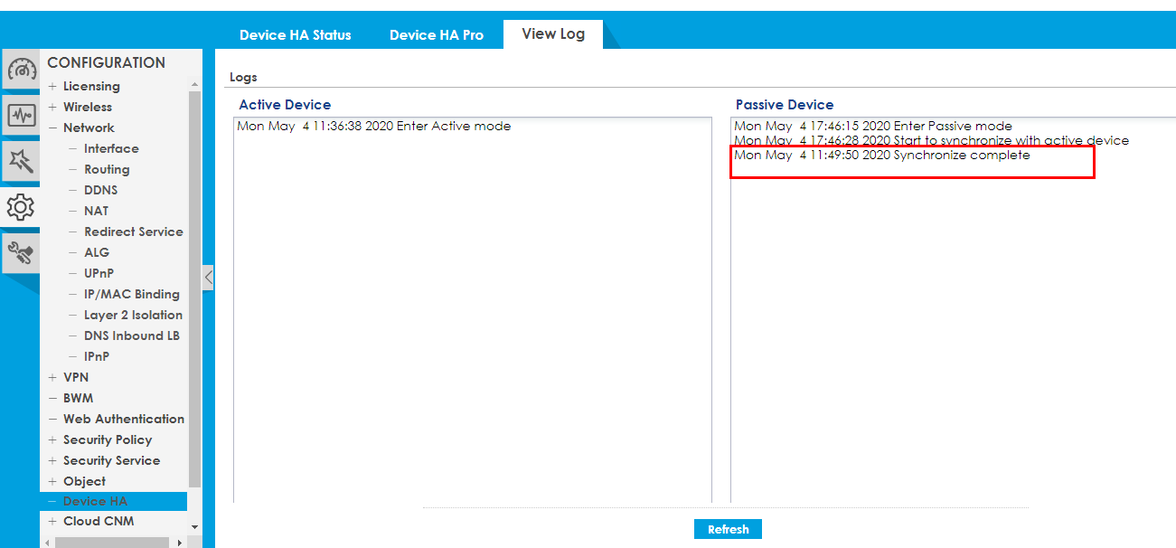

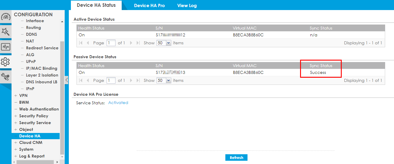

Checking the synchronization status through the Web Interface:
CONFIGURATION > Device HA > View log there must be Synchronize complete.

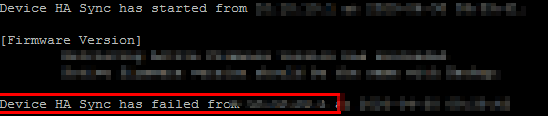

When doing a firmware upgrade, the passive device will upgrade firmware first and then reboot.
After the passive device reboots, it will be conducting a full configuration synchronization immediately.
The synchronization will fail since the firmware of the passive device is different from the active device.
It is normal behavior and you can ignore the failed synchronization logs in this case.
