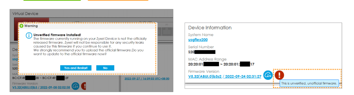

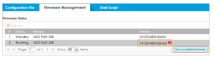

If you have a message "This is unverified, unofficial firmware", "Unverified firmware installed", or "Firmware Integrity check Fail.", this article explains why.

This means you're on a datecode firmware, or the firmware has been manipulated somehow.
How do I know if the firmware has been compromised?
If you have an official firmware 5.32(ABUI.0)C0, for example, and this "unverified" message show, this would mean that the firmware could be compromised. However, if you have an unofficial datecode firmware (weekly firmware) (e.g. 532ABUI0ITS-22WK31-r104914), this only means that the firmware is a datecode firmware which is not yet officially verified and you don't need to worry.
