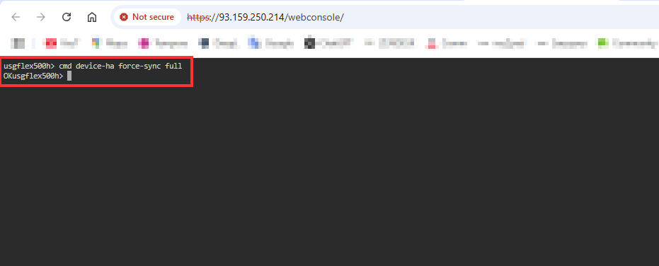

In the upper right corner of the device's web interface and click on “Web Console”
enter the command:
cmd device-ha force-sync full
Check status (After that, the latest synchronisation status and all changes will be updated correctly)
