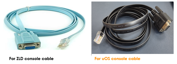

To connect to the USH FLEX H Series with the new uOS operating system, we use the standard RJ-45 to DB-9 Rollover Cable
[Change] - Use general console cable pinout, and it is not compatible with ATP/USG FLEX series. So if you have problems connecting to the Firewall using the console cable, please make sure you are using the correct cable.
