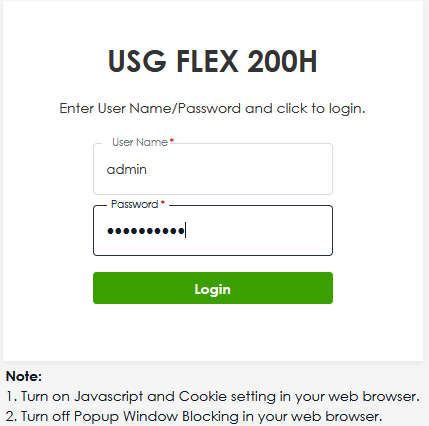

To access the USG FLEX H web configuration page, open a web browser on your computer (e.g., Internet Explorer, Mozilla Firefox, Google Chrome). On the address ba,r please type http://192.168.168.1 to access the WebUI. The Login screen appears.
Note: Default login: admin/password, as shown on the device sticker. If no sticker is present, the default password may be 1234.

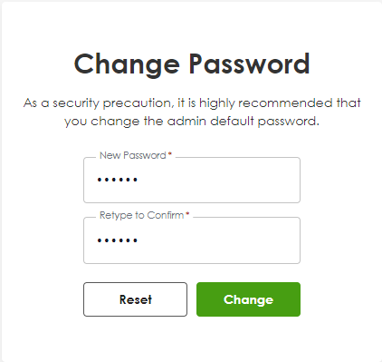

Note: The value in this field is invalid. It can consist of 4-63 characters. The valid characters are [0-9][a-z][A-Z]['(){}<>^`+/:!*#@&=$\.~%,|;-"]. Space is also not allowed.
Note: If the default password has been changed, use the new password to log in. If this is the first time setting up the device and it is not accepting the "1234" password or password, as shown on the device sticker, please press the RESET button on the device (located on the front panel) and hold it down for 10-15 seconds
