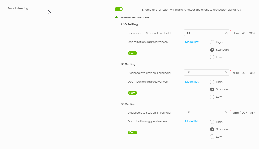

The best way how Improve WiFi roaming on my Nebula Access Points is to enable Smart steering. Smart Steering is used when you have more than 1 AP. This prevents "Sticky clients", which is a term used for WiFi clients that are connected to an AP (AP1), and when they move to the next AP (AP2), they do not connect to the AP2, even though the signal is better on AP2. This is because they still have a signal on AP1 (even though it's bad), the client determines that the signal is enough for an internet connection.
Here we can enable Smart Steering, which forwards a client to the next available AP when the signal reaches a certain "low" level. This ensures that you have the best possible signal wherever you are in the environment. If the client gets too low a signal, and there is no AP around that can give a better signal, they will kick the client out of the WiFi completely. The client needs to go closer to the AP again to be able to connect.
Best Practice values (On both 2,4GHz & 5GHz)
Optimization aggressiveness option that supported on specific models provides different traffic rate threshold levels when the Nebula Device takes action to improve the access point’s WiFi network performance. The Nebula Device will postpone the actions implemented on access points until your network is less busy if the threshold is exceeded.
You can select a suitable traffic rate threshold level for your network.
Low: Select this if you want the Nebula Device to postpone the action set when the access point network traffic is low.
Disassociate Station Threshold: -88 dBm
When the signal reaches below -88 dBm, kick the client out of the WiFi and don't let it be able to connect until the signal gets better than -88 dBm
- How to configure?
Go to Site-wide -> Configure -> Access points -> Radio settingsRoaming protocols

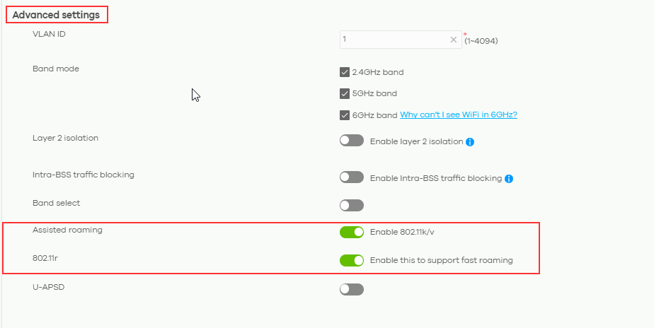

- 802.11r - IEEE 802.11r is a standard for fast roaming in a wireless network, also referred to as Fast BSS Transition (or Fast Roaming). Without support for 802.11r, this would require the client to re-authenticate causing issues for users (source). If you're having RADIUS / Active Directory authentication, this should be enabled.
- Best Practice values (On both 2,4GHz & 5GHz)
Disable 802.11r, if you're not using 802.11x (RADIUS or AD authentication) on WiFi
- 802.11k/v - The 802.11k standard helps devices search quickly for nearby APs that are available as roaming targets by creating an optimized list of channels. When the signal strength of the current AP weakens, your device will scan for target APs from this list (source). However, the protocol isn't supported on all devices, which can lead to problems.
- The 802.11v standard can direct devices to roam and can accept and respond to these Basic Service Set (BSS) Transition Management frames, leading to improved WLAN quality when connected to a network that supports 802.11v (source). However, the protocol isn't supported on all devices, which can lead to problems.
Disable 802.11k/v, if you have roaming issues. This might be because of unsupported devices, or other issues related to the protocol.
- How to configure?

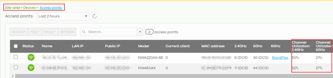

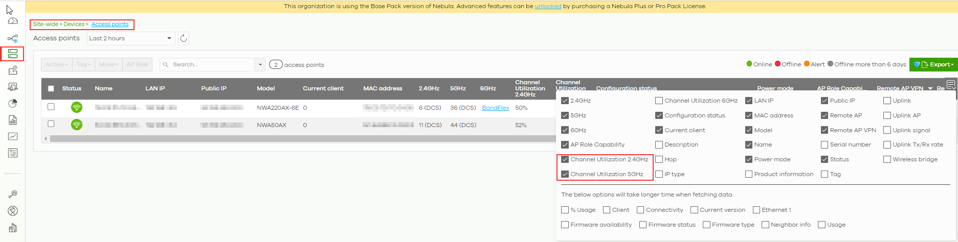

- How to check your interference level
Go to Site-wide -> Devices -> Access pointsClick on the "document/list" icon and select the channel interference on 2,4GHz & 5GHz (6GHz)

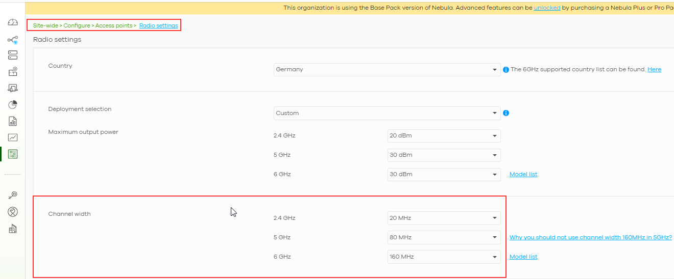

- Channel Width
Whenever you experience a slow WiFi, this could be because of interference. To reduce the interference level (channel utilization), you can turn down the channel width. This will decrease the WiFi throughput overall, but if you have high interference levels, you will increase the throughput (speed). Channel width operates on a frequency spectrum from 20 MHz up to 160 MHz channels, higher channel width means increased maximum speeds, but also increased risk of interference.
If you're experiencing inconsistent speeds, WiFi disconnections, etc., turn down the channel width to 20 MHz on both 2,4 GHz and 5 GHz.
- How to configure Channel Width?

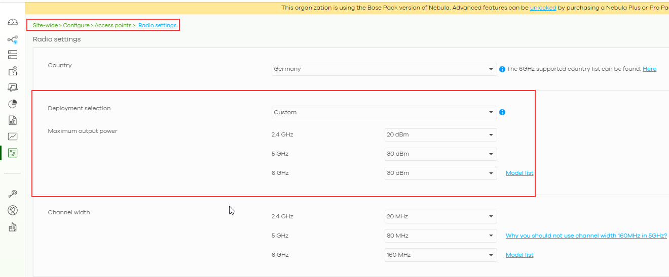

Go to Site-wide -> Configure -> Access points -> Radio settings- Output power
A common problem will be that in order to avoid interference, you turn down the output power of the APs. However, this will create "grey areas" in your WiFi environment where there is no WiFi connection.
However, sometimes it is necessary to turn down the output power, because of an incorrect WiFi installation.
Start with decreasing the output power with 3-5 dBm to the radio that has high interference (e.g. 2,4GHz) to see if this helps the interference level (See section 2.1.2 How to check your interference level). If channel utilization goes down, try to decrease it again with 2 dBm. If channel utilization stays the same, there could be other issues such as "DCS" settings (see 2.2.1 Dynamic Channel Selection (DCS) Settings).
- How to configure Output Power

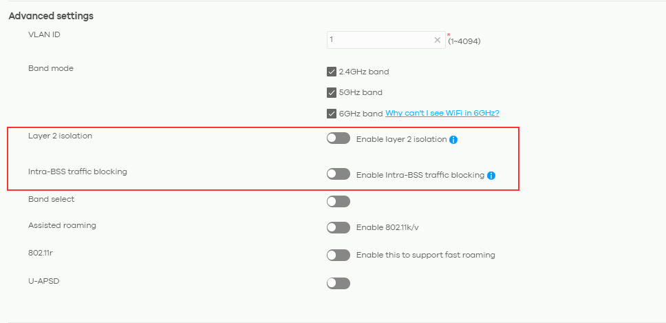

- Intra-BSS traffic blocking - Cannot reach devices in my network
Intra-BSS Traffic Blocking makes sure that the wireless clients cannot talk to each other and is an important part of the Layer 2 isolation. When this is enabled, the device (e.g. Chromecast) won't be able to talk to the mobile phone, laptop or any other clients in the network which will prevent the connection to be established. Best practice for Intra-BSS Traffic Blocking is to only enable this for Guest WiFi's that is for clients that you don't trust.

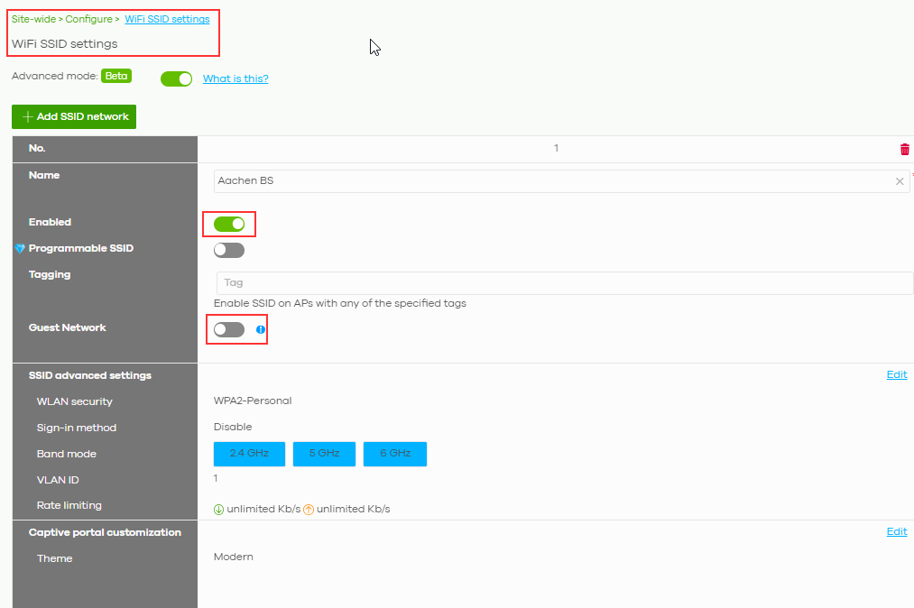

- How to disable Intra-BSS Traffic Blocking?
Make sure SSID is enabled and Guest Network is disabled
Go to Site-wide -> Configure -> WiFi SSID settings
Make sure that Intra-BSS traffic blocking and Layer 2 isolation are disabled

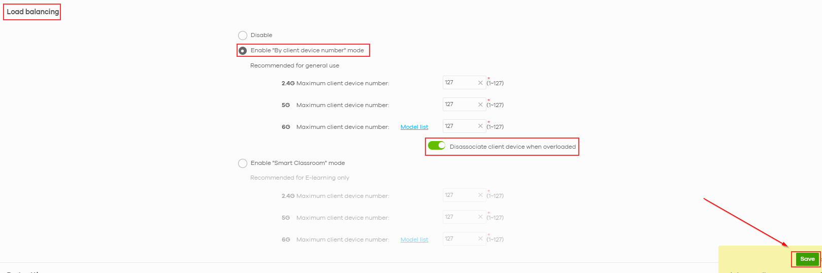

- Load Balancing
If you're having users kicked out from the WiFi, when there's a little higher load than usual. It could be useful to configure Load Balancing to balance out the clients when the load gets too high.
Utilize the Load Balancing function to control the number of devices connected.
- Choose “Enable by client device number mode".
- Input 2.4G/5G Maximum client devices number. For a more stable and efficient WiFi connection, we recommend limiting the number of connected wireless clients to 15-20 per AP at the same time.
- Toggle “Disassociate client device when overloaded”. When the station number is greater than the max station number, AP disassociates clients with the longest idle time and the poorest signal strength.
Go to Site-wide -> Configure -> Access points -> AP & port settings
