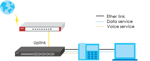

Nowadays IP phones are commonly used in office environments to give voice traffic a higher priority is an important consideration when designing a network. In a common scenario the IP phone is connected to a switch on one end while linking the PC or laptop on the other end bridging both devices. In this case, Voice VLAN is an important feature used to easily mark and prioritize voice packets from IP phone, separating data packets from the PC. In the following configuration guide, the goal to achieve is to separate traffic between the IP phone and PC without having to set individual VLAN tags for them. The Switch will add VLAN tags for voice & data packets separately upon receiving them and then forwarded to the uplink.
Scenario:

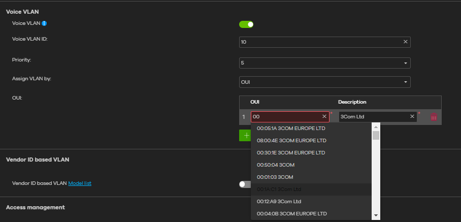

2. Set up Voice VLAN
Navigate to:
Site-wide > Configure > Switches > Switch Settings
Then configure Voice VLAN settings. Specify the VLAN ID and OUI addresses of the IP phones. OUI are the first 3 bytes (first six digits) of a MAC address that represents the vendor. Through specifying the IP phone MAC address, the switch can identify voice traffic accordingly. Nebula cloud switch supports up to 6 vendor OUIs.
After saving Voice VLAN settings, all the switches in the same Nebula site will then be able to recognize and prioritize voice traffic.
