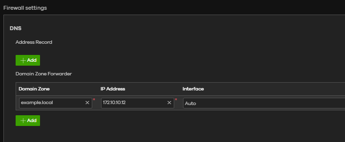

2) Configure the DNS server in the firewall settings
Navigate to Firewall -> Configure -> Firewall Settings and add a new Domain Zone Forwarder to forward the domain to the DNS server through the VPN through the already automatically configured "auto" interface and hit "save".
Navigate to:
Site-wide > Configure > Firewall > Firewall Settings
