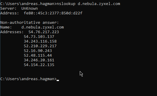

Nebula devices try to connect via Port 6667 or Port 4335 to the Nebula cloud, and refer to the FQDN d.nebula.zyxel.com or s.nebula.zyxel.com.
Perform a nslookup to see if your gateway can resolve these addresses:
Some ISP-DNS-Servers have problems in resolving this FQDN, so we recommend using the DNS-Server 8.8.8.8 (Google) or alternativel 1.1.1.1 (CloudFlare DNS), since these DNS servers are mostly easily reached. It might be, that otherwise the request in resolving the FQDNs towards your ISP-DNS' will exceed the Time-To-Live of the DNS-requests.
