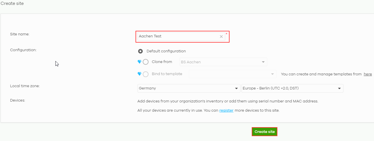

- Login to your Nebula account using your credentials. In the top bar, you will see a dropdown box labeled "Site:"
- Look for the "Create Site" option and click on it.
- You will be asked to enter a name for your site. Pick a suitable name.
- Upon entering the site name, click on the "Create site" button to complete the site creation process.
- Your site is now set up, and you can start adding devices and customizing them to your preference.

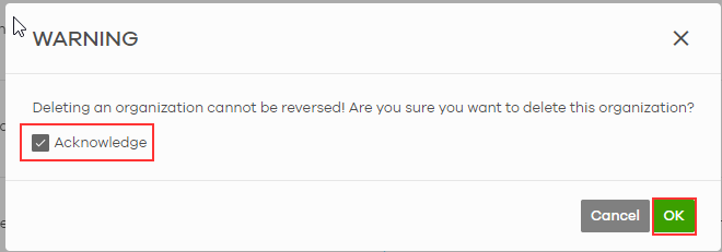

- Click on the "Delete organization" button. After that, you will see a warning message "Deleting an organization cannot be undone! Are you sure you want to delete this organization?
- Click on the "Delete organization" button and after that, you will see a warning message "Deleting an organization cannot be undone! Are you sure you want to delete this organization?". If you are sure, check the Acknowledge checkbox and click the "Delete" button.
The organization and all associated sites will be deleted from Nebula.

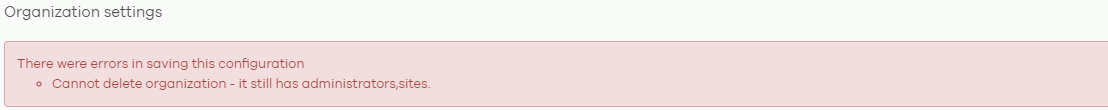

What could go wrong?
- Cannot delete organization - it still has administrators and sites.
- You can delete this organization only if it has no sites, administrators, users, licenses, or devices registered in this inventory. Please check your setting below: sites, administrators, licenses/devices of devices.
