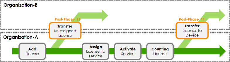

License Activation Process
Adding Licenses
- Nebula administrators can input license keys to add add-on licenses to an organization
- Bundled licenses are added to organizations at the same time its bundled device is added
- Added licenses all start in an inactive state.
- Licenses in an inactive state mean it has not started its expiration countdown/timer

Un-assigning PLUS/PRO Pack Licenses
- Allows licenses to be assigned to another device
- Licenses can be un-assigned before activation
- Licenses cannot be un-assigned after activation
Transferring PLUS/PRO Pack Licenses
- PLUS/PRO Licenses can be transferred to a different organization with the same owner or administrators with delegated authority
- Un-assigned licenses can be transferred
- Assigned licenses can be transferred

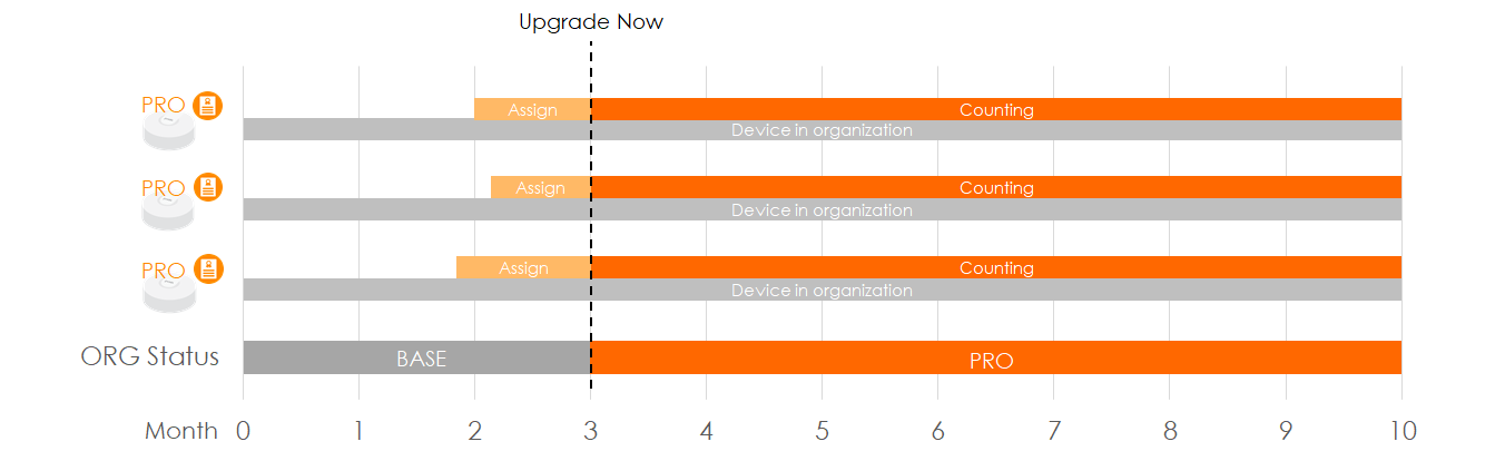

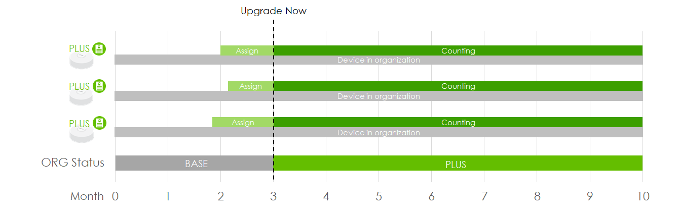

Upgrading Organization Status
[Upgrade] button can upgrade an organization when:
- PLUS/PRO service is not in an active status
- All devices are assigned with PRO pack licenses
- All devices are assigned with PLUS pack licenses
- All devices are assigned with a mix of PRO/PLUS licenses
- Clicking [Upgrade] causes:
- Assigned PLUS/PRO licenses to start counting its expiration countdown/timer (at most one license per device)
- Changes organization status to PLUS or PRO
Upgrading Base Pack Organizations – PLUS Pack
Upgrades to PLUS organization if all devices are assigned with PLUS Pack licenses
Upgrading Base Pack Organizations – PRO Pack
Upgrades to PRO organization if all devices are assigned with PRO Pack licenses

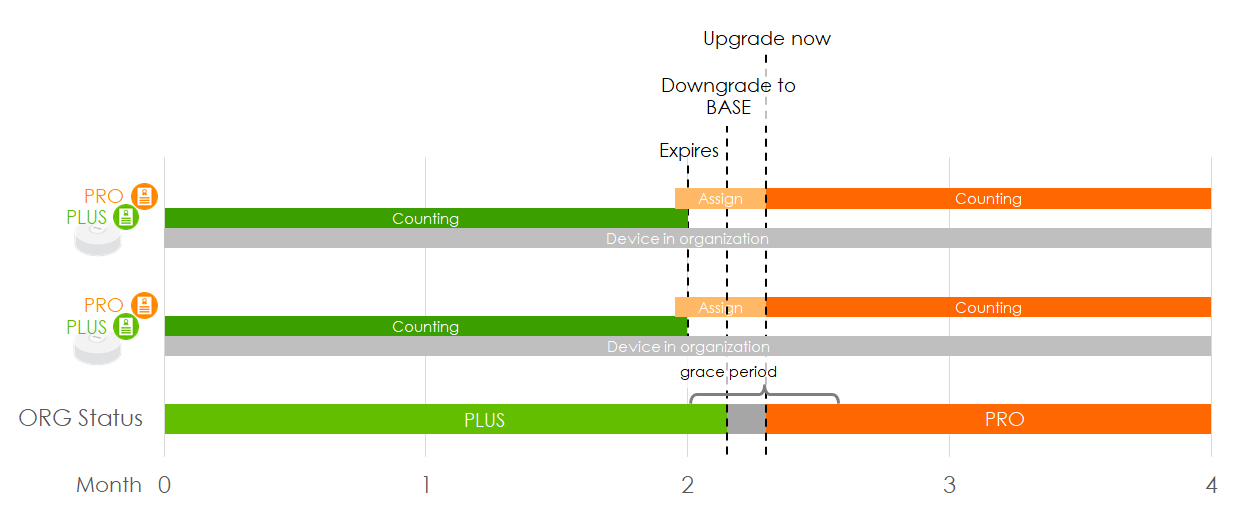

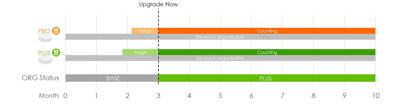

Upgrading Base Pack Organizations – Mixed Licenses
- PRO pack licenses cover both PRO and PLUS pack tiers
- PLUS pack licenses cannot be used to upgrade the organization to PRO pack tier

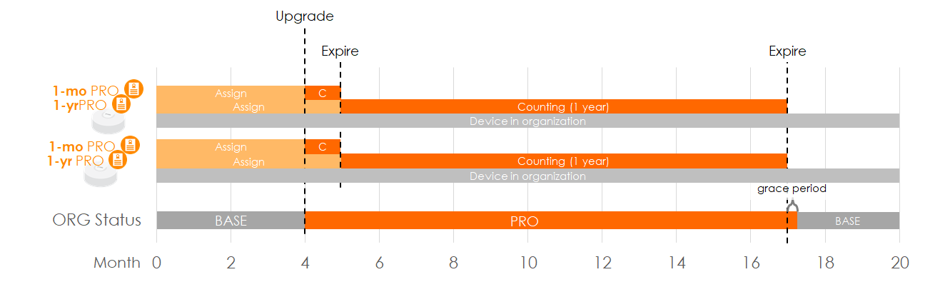

Maintaining Organization Status

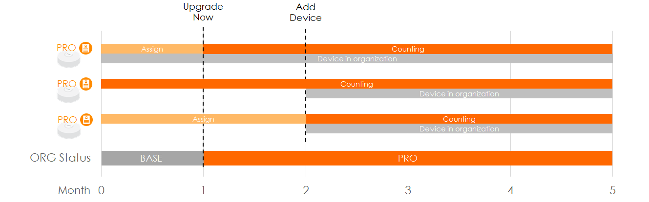

- Nebula administrators can extend PLUS or PRO period by assigning multiple licenses to a device
- When an assigned license expires, an extra assigned license takes over and starts counting its expiration countdown/timer
- Adding new devices into a PRO organization, NCC can maintain PRO status by counting any bundled or add-on PRO pack license assigned to this device
Order of counting multiple assigned licenses:
- bundled à add-on (shortest duration) à add-on (longest duration)
Maintaining Organization Status – Assigning Extra Licenses
Any license that expires is immediately replaced with the extra assigned license:

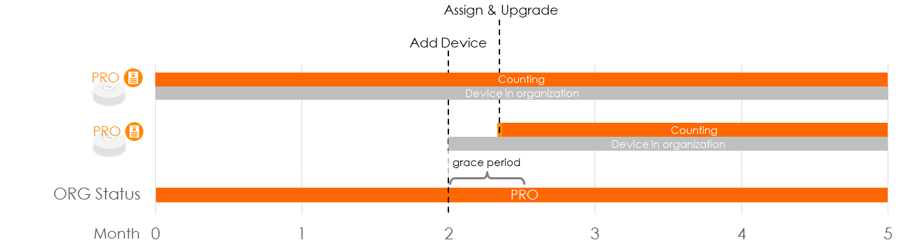

Maintaining Organization Status – Adding New Device
Adding a new device to PRO/PLUS organization with a non-counting license will start counting as soon as it is added:

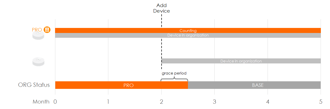

Adding a new device without an assigned license causes the organization to enter the grace period.
The license must be assigned and the [Upgrade] has to be pressed again.

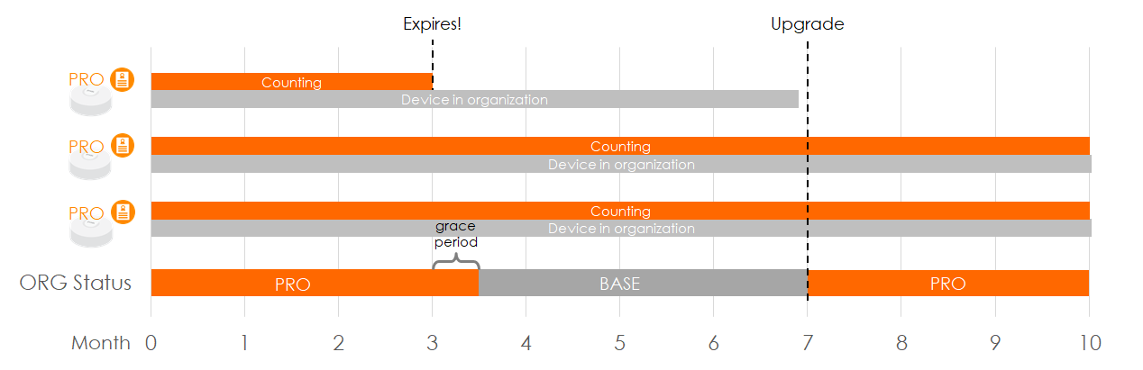

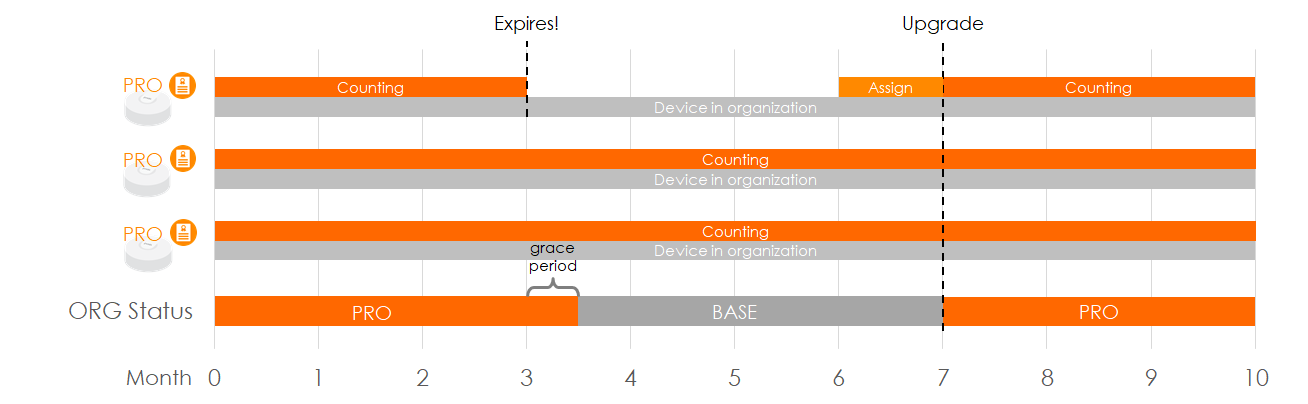

Downgrading Organization – Expiration
- PLUS or PRO organization downgrades if any counting license expires
- Licenses may not share the same expiration date because licenses may be transferred from different organizations
- NCC initiates a 15-day long grace period when one or more licenses expire
- Organization downgrades if nothing is done after the grace period ends
- The grace period provides administrators time to assign new licenses
Downgrading Organization – Expiration (and Recovery)
- Administrators can assign a license to a device with an expired license
- Must select [Upgrade] to recover organization status
- Administrators can remove the device with an expired license
- Must select [Upgrade Now] to recover organization status
Downgrading Organisation – Adding New Device
- The organization may downgrade if a new device is added or transferred to the organization carrying none or a lower license tier license
- PRO/PLUS organization downgrades to BASE if added/transferred device has no assigned license
- NCC initiates a 15-day long grace period before the downgrade
Changing Organization Status – PLUS -> PRO

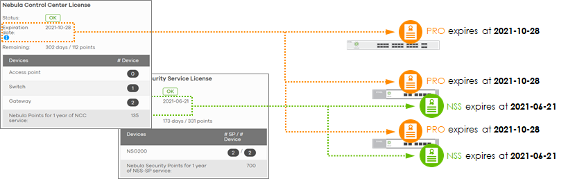

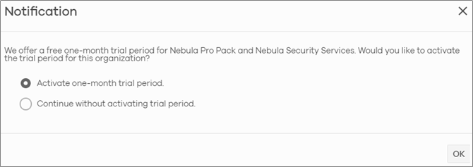

Trial Organization - what does it mean?
New organizations created by any Nebula account have 30-day full access to all PRO Pack and NSG-based Security Service features. There is no limit to the number of sites or devices that can be added to an organization. NCC sends an email notification when the trial period expires on 21/14/7/1 day(s). It is optional to activate the trial during the final step of creating a new organization: Please keep in mind that this is the only time when you can activate the trial period. You won't get a second chance later

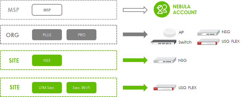

Types of Licenses – Summary
License – MSP Pack
- Bound on: Nebula Account
- Available as: Add-on License
- Scope: MSP
- Duration: 1-year/2-year/1-month
Description: Unlocks MSP menu and all features included
- MSP Branding
- Admins & Teams
- Cross-org synchronization
License – PLUS Pack
- Bound on: AP, Switch or Security Gateway
- Scope: Organization
- Description: Unlocks PLUS pack features; Upgrades Organization Tier to PLUS
License – PRO Pack
- Bound on: AP, Switch, or Security Gateway
- Available as: Bundled License, Add-on License
- Description: Unlocks PRO pack features; Upgrades Organization Tier to PRO
License – UTM Security Pack
- Bound on: Any USG FLEX model
- Scope: Per-device
- Description: Unlocks Security Services supported by USG FLEX
- Additional Info: UTM licenses come with a specific USG FLEX model
License – Secure WiFi
- Scope: Per-device
- Description: Unlocks Remote AP for Teleworker solution
- Additional Info: Secure WiFi licenses come with a specific USG FLEX model
