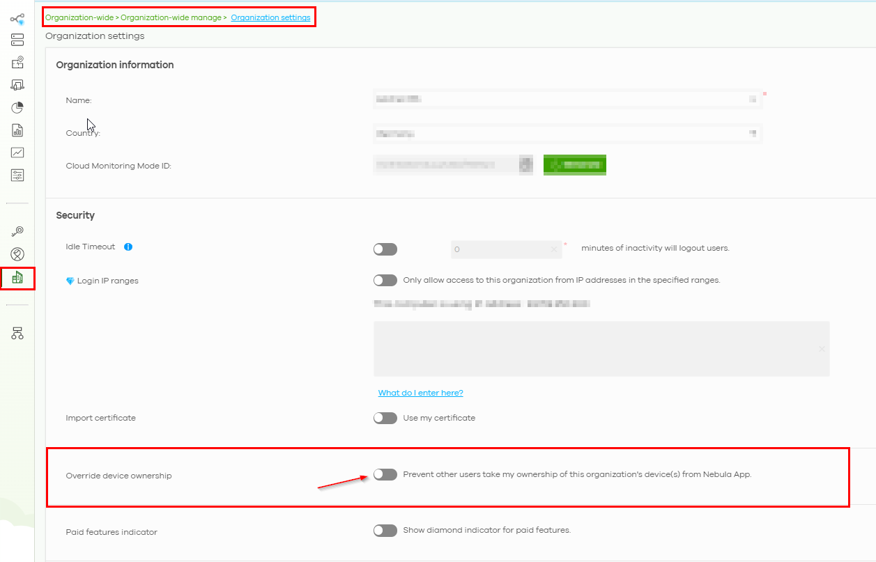

Protect your Device from being Overwritten

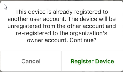

If you don't want the QR Code to be overwritten, you can prevent other users to take ownership of this organization's device(s) from the Nebula App.
| This device is already registered to another user account. The device will be unregistered from the other account and re-registered to the organization's owner account. Continue? |
Organization-wide > Organization-wide manage > Organization settings

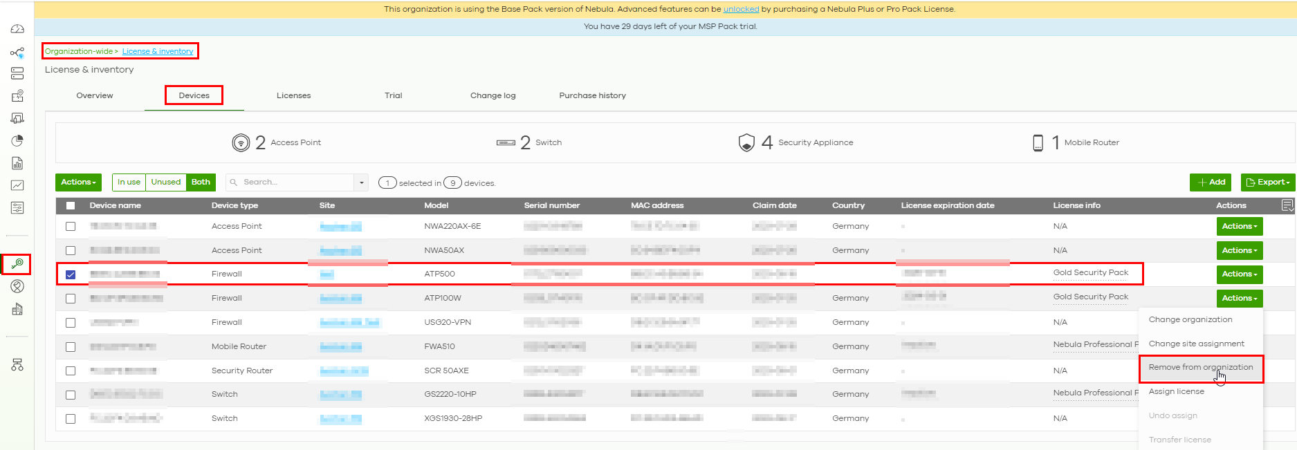

Navigate to Organization-wide > License & Inventory > Device tab
- Mark the device(S) you want to remove by clicking on the checkbox left of it
- Click on the Action button and select the option "Remove from Organization"

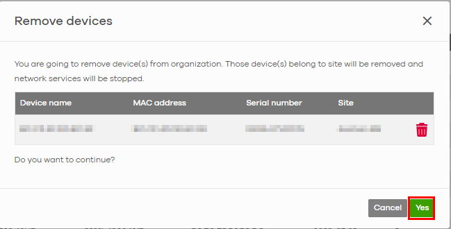

- A confirmation pop-up window with a summary of the actions will appear, click Yes to proceed
- Now you should see that the device is not included in your organization anymore. The device will revert back to factory settings after being removed from the Organization.
